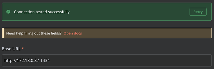

Once they are both on the same network, you can use the container name as the host. In the above example, the container name was called “ollama” and it listens on the port 11434. Therefore, to set up credentials you would use the Base URL http://ollama:11434.
Alternatively, if no name given to the container, you can check the container IP address (given the network name we provided in the above example “n8n_network”):
# check all the networks
docker network ls
# check the containers connected to your network
docker network inspect n8n_network
        "Containers": {
            "0ad64eeaa1845d254a0e26c672912b1d36fe1db91b280ca352d371e5e62cf38d": {
                "Name": "ollama",
                "EndpointID": "7c7932518a0376077435be0e0708999e56ae8fc7ad3f3af990b82da27f7e9390",
                "MacAddress": "02:42:ac:12:00:03",
                "IPv4Address": "172.18.0.3/16",
                "IPv6Address": ""
Note the IP adress of “ollama” container is 172.18.0.3. Hence the below should also work.
