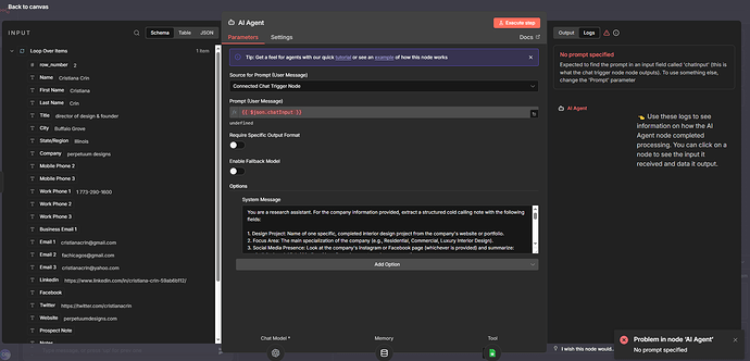

  1. AI Agent Prompt Issue
    When I run the workflow, it stops at the AI Agent and says:
    “No prompt specified. Expected to find the prompt in an input field called ‘chatInput’ (this is what the Chat Trigger node outputs). To use something else, change the ‘Prompt’ parameter.”
I’m not sure how to fix this.

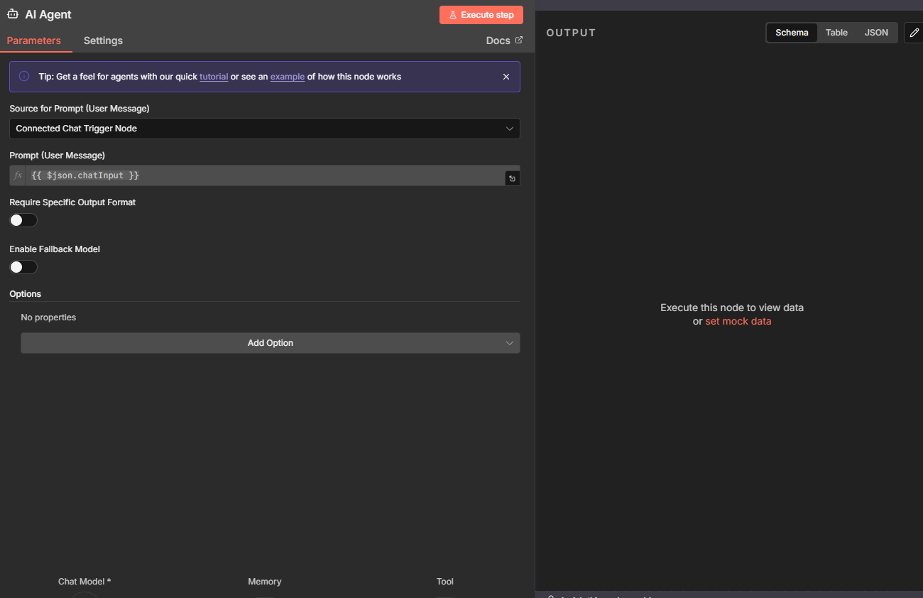

For the chat trigger to work you need to use the chat trigger, or you can define by a diffrent prompt by clicking on the connect chat trigger node dropdown @Oliver_Beier
Hi @Oliver_Beier Your concerns are right that about the processing large sheets, for the error just add a Chat Input Trigger to your workflow if it is already present consider refreshing the AI Agent node by toggling between options for AI prompt, and for the processing large sheets AI Agent can you can specify this in the system prompt and it will adapt to it.
If your website,social media links and etc, are available in the sheets the AI Agent can fetch it without any overhead of you having to manually enter data every time, and for the system to work just refresh or connect the Chat Input Trigger to the AI Agent node that would make it work , let me know if you need any help!
Hi all,

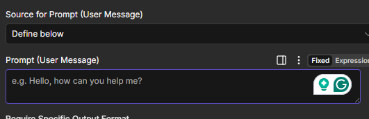

@Oliver_Beier, the issue is that no prompt is specified:
You just need to edit the option: Source for Prompt (User Message) > define below:
Then write your prompt, whether it’s fixed text or an expression that references previous node fields..

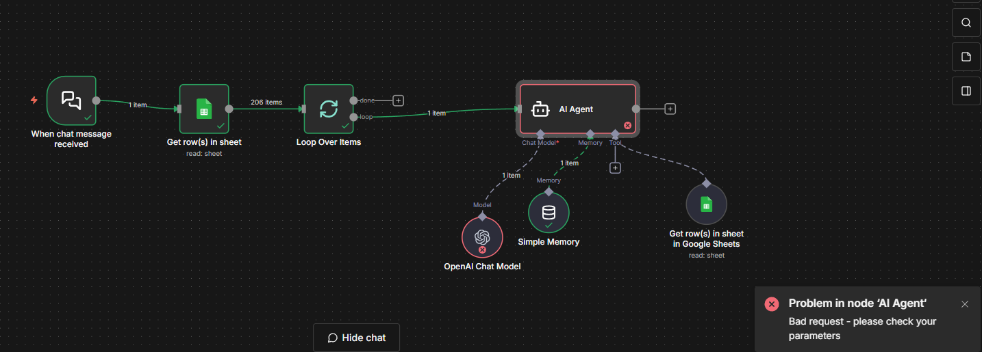

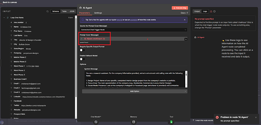

Hey mohamed3nan Now i have tired to Change that now it say this.
This is my Workflow i think im doing Somthing Wronge.
thank you in advance

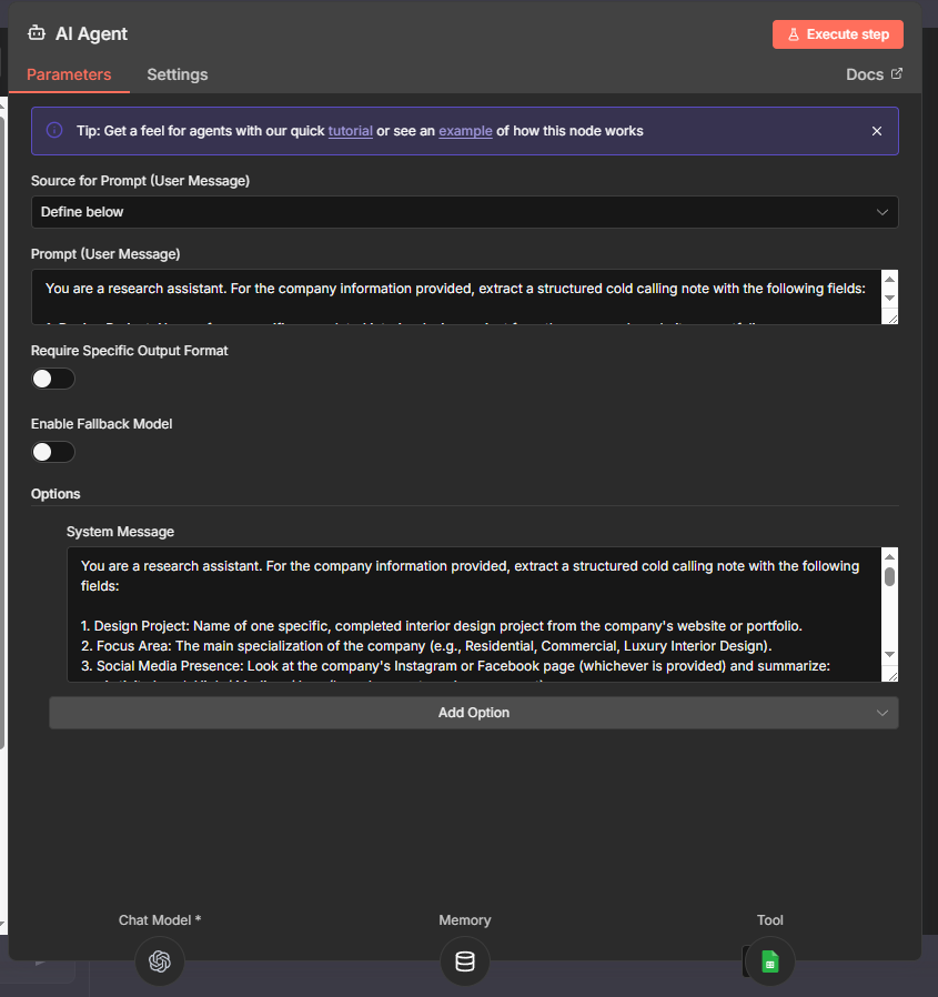

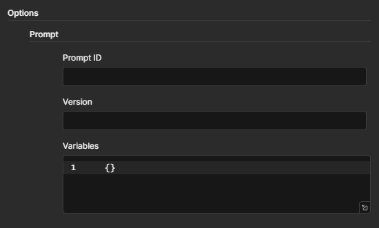

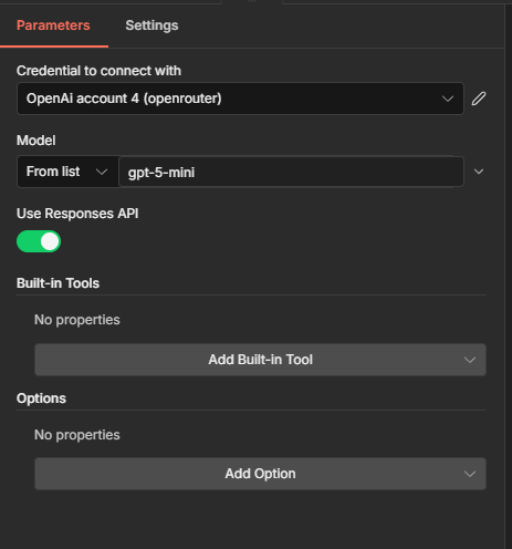

open the OpenAI node and remove all Options including this:
i do not think you need that..
Hi :slightly_smiling_face: Thanks for your reply. I’ve tried the things you suggested (adding/refreshing the Chat Input Trigger, reconnecting it to the AI Agent, and refreshing/toggling the AI Agent node), but unfortunately it’s still not working and I’m not sure what I’m missing or what I should do next.
All my website and social media links are already inside Google Sheets, so I expected the AI Agent to just fetch them automatically. From what you describe it sounds quite simple — like it should just be a matter of sending the prompt — but I can’t get it to work in practice.
Could you maybe explain more step-by-step what I should check or change? Thanks :slightly_smiling_face:

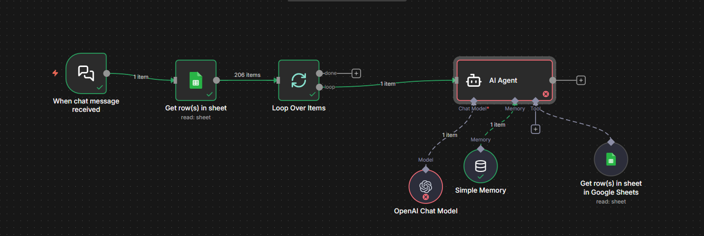

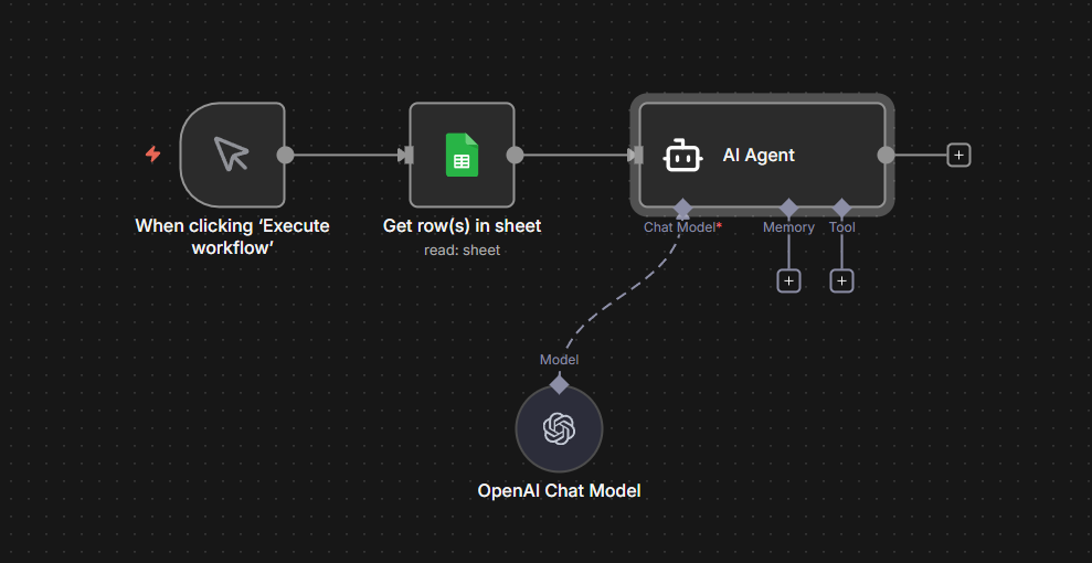

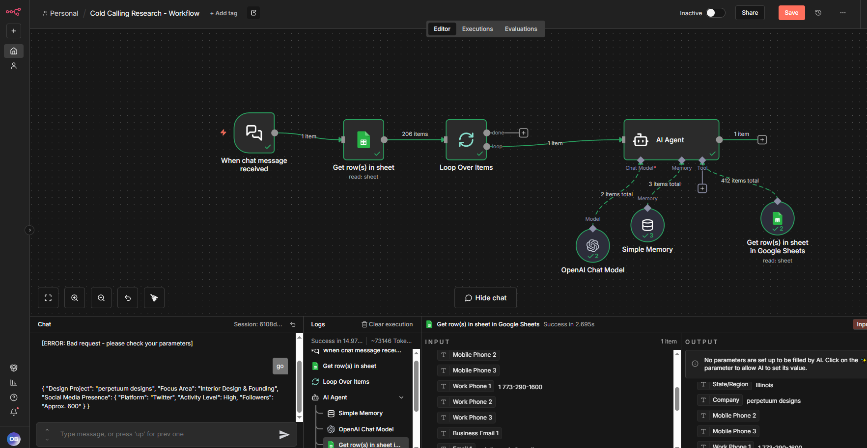

This is is my Workflow Right now.

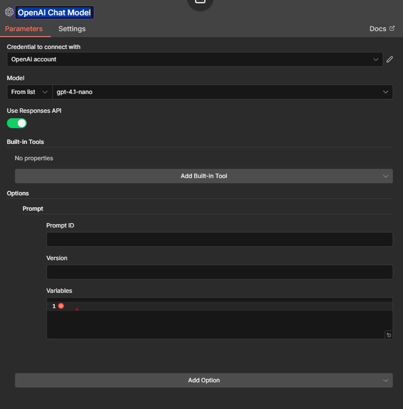

Hey mohamed3nan
im in the OpenAI Chat Model and i don’t see anything in those boxes

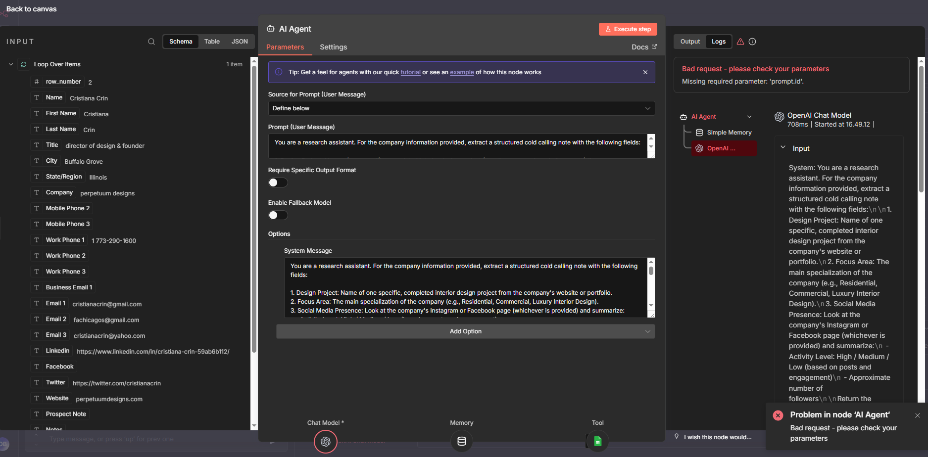

and this is the AI agent itself and that has a prompt in it

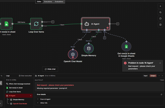

and this is the error im getting.
@Oliver_Beier with the error i could say that the CHAT model you are using does not work and gives a bad request, is your n8n instance on the latest version? Yes you are close with that one, just i would recommend try switching to gemini models and see how well it works! Let me know what works.

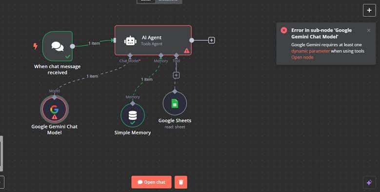

Hey — I think something worked, but I’m not totally sure.
You can see in the chat that it provided some information about the company. I just have two questions:
First, I fact-checked the information, and it’s not completely accurate or as detailed as I expected. For example, instead of saying “Focus area: interior design,” I would prefer something more specific, like “residential hospitality interior design.” It also mentioned “interior design funding,” which isn’t correct. I noticed it used 73,000 tokens — is that a lot, and if so, is there a way to reduce that?
Second, I checked my Google Sheets, and although it pulled some information, it didn’t write anything back into the “Prospect Note” column where I wanted it to.
@Oliver_Beier Your OpenAI node worked out and that is why everything started running as expected.
Your issue with the incorrect information might be aligned with your system prompt & AI prompt, and your token usage is clearly the result of the AI agent fetching 412 rows from the google sheets, you can regulate that in the node settings, and as for your ‘didnt write anything’ it is because you did not gave the AI agent enough tools so that it could write something, your AI agent part should look like this to align with your read and write requests.
This would help you achieve your goal.
