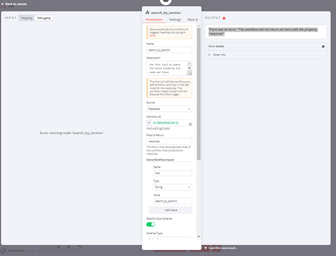

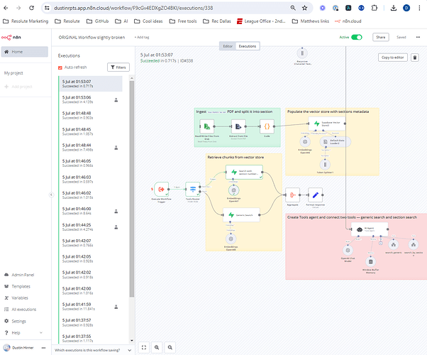

Thank you so much @oleg. I feel like I am super close to replicating what you did but in my own workflow (and with using supabase instead of pinecone).
Running into an issue getting the workflow to utilize the section_number tool properly. See that attached screenshots.
I feel like I am so close. I will be pasting what I have done thus far so you can review and let me know where I am being an idiot.
I couldn’t get a checkmark by “Aggregate”… so, I’m guessing there is something wrong with the “Search with section number” node.
and it says “No output data returned”
I got it to work 1 time! But, it didn’t return a lengthy response.
I got it to partially work if I kept it as a super duper simple question. @oleg

Hi @dustinAIAIDE, glad to read you’re getting close!
A few things I noticed in your workflow:
  1. There’s a typo in the Search with section number meta1 node’s “Prompt”. You’re using expression syntax, but the field setting is set to “fixed”. So you’re not actually passing down the agent’s query for vector search.
  2. If the model isn’t sending the section number, you can try to force it by setting both fields as required in the schema:
