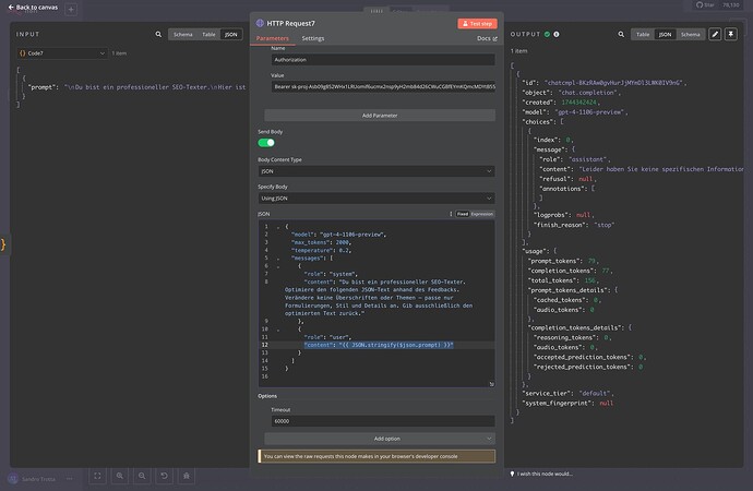

:x: Problem
Although Code7 outputs the correct prompt, the HTTP node sends an empty or incomplete value to OpenAI.
Response:
“Unfortunately, you have not provided any specific information or data that I could convert into an optimised JSON text.” (just in german)

Since you are saying Code 7 outputs the correct prompt but fails at HTTP request it could be a referencing issue of the finalPrompt from the previous node. can you verify and revert

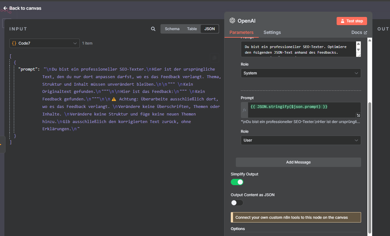

Hey,
this should be fine, but I’m new to n8n and maybe I did something wrong. Here’s a screenshot of the input, the node and the output (see ‘Content:’ where it says: Unfortunately, you did not provide any specific information or data that I could convert into an optimised JSON text).

Sorry. Hadnt had time to come back to this thread. The latest screenshot is quite helpful. I think in the line where you have
“content”: “{{JSON.stringify($json.prompt)}}”
this could be the issue. this is turning your prompt into a quoted JSON string including extra quotes and escaping like this “"Du bist ein professioneller SEO-Texter…"”
The open AI is going nuts since its being passed a string inside a string.
Replace that line with
“content”: “={{ $json.prompt }}”
The = at the beginning is crucial — it tells n8n to evaluate the expression and inject the value directly, instead of treating it as static text. try it out and let me know
Hmm, unfortunately it doesnt work :confused:
The Code looks like that now:
  "model": "gpt-4-1106-preview",
  "max_tokens": 2000,
  "temperature": 0.2,
  "messages": [
      "role": "system",
      "content": "Du bist ein professioneller SEO-Texter. Optimiere den folgenden JSON-Text anhand des Feedbacks. Verändere keine Überschriften oder Themen — passe nur Formulierungen, Stil und Details an. Gib ausschließlich den optimierten Text zurück."
      "role": "user",
      "content": "={{ $json.prompt }}"
But the output is always the same. “Unfortunately, you did not provide any specific information or data that I could convert into an optimised JSON text”
Hi @delsupreme , Why dont you use the OpenAI node directly?!
something like this:
can you retrace back and see whats the $json.prompt like in Code 7 output and could you also share what does the code look like for Merge2 and Code7. Basically I am trying to figure out how the shape of the input is whether the generatedText or feedback is inside nested keys
I have now set it up like this and it seems to work :slight_smile: Would you use different settings than I have here?
