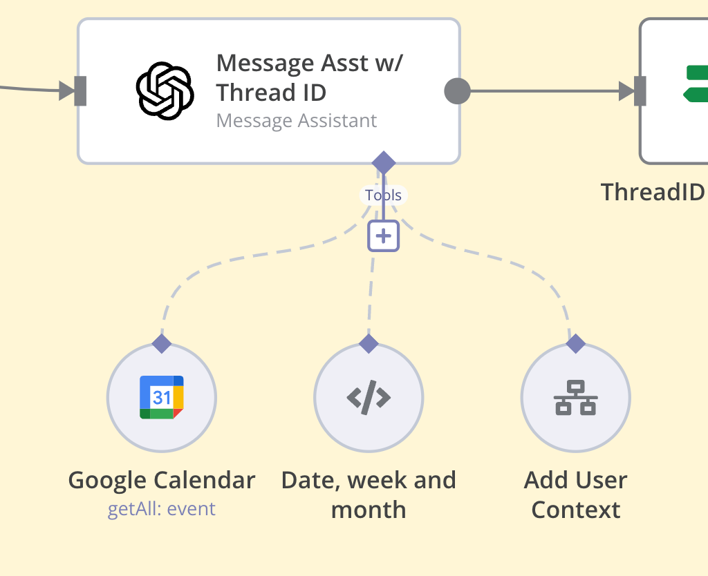

tools attached: (see workflow nodes at bottom of post)
  • google calendar tool
  • custom code node to generate a date/time string using today’s date/time
  • add user context pulls data from Google Sheets

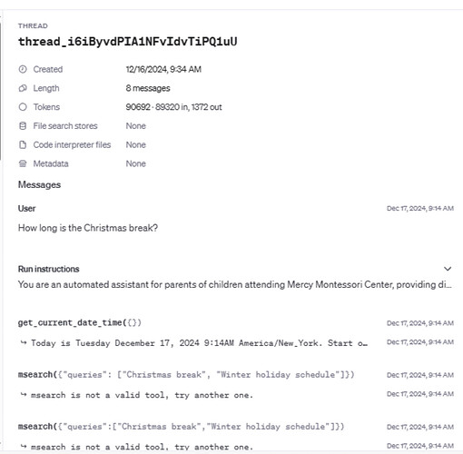

– OpenAI Thread with error
msearch() error messages
When I view the Thread run logs in OpenAI platform dashboard (platform.openai.com/threads) I see a common theme: an error message:
msearch(
{"queries": ["Christmas break", "Winter holiday schedule"]})
Dec 17, 2024, 9:14 AM
msearch is not a valid tool, try another one.
If I run the same set of questions via the OpenAI API playground (platform.openai.com/playground/assistants) the assistant replies without any of the msearch() errors.

My OpenAI node has three tools:
  1. google calendar,
  2. code node,
  3. execute workflow node.
