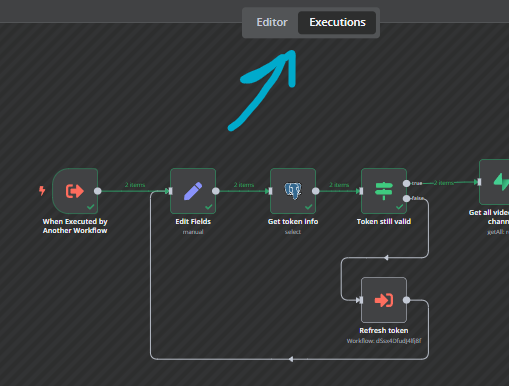

I see. I didn’t mean production workflow. I meant production execution.
Here is the difference:
When you click Executions on the top of your workflow,
You will see an execution list on the left. If the execution has a test icon, you ran the execution manually by clicking the buttons in the editor. If it doesn’t have the icon, it means the execution happened by itself, automatically, without human intervention in the editor.
Test executions (the ones you execute manually) store data in your browser cache while you are testing. Sometimes that data is too much to handle and you browser has a hard time trying to keep up.
The executions that happens automatically (when triggered, called by a webhook request or called by another workflow) happens totally on the server side, so data is not stored on your browser and that problem doesn’t happen.
