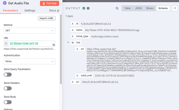

file that doesn’t work:

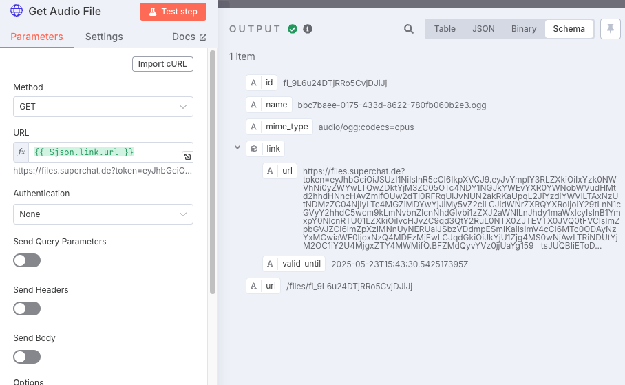

file that works:
Is there anything I can do with the get request downloading the file to make sure the binary arrives in n8n differently?
It seems there is no way to receive the file differently than with the wrong mime type. It seems Gdrive optimizes the file and takes the opus encoding out. Is there any way to do that in n8n? I have been looking at cloudconvert but it is not optimal. Are there any alternatives maybe even something else if it is on the hosted version instead?
