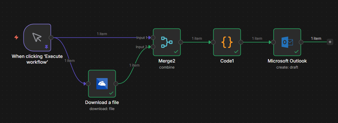

No, it works correctly on my end:

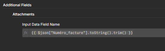

Your issue is with your Code node and the binary referencing:
In most cases, you do not need to use a Code node unless you know exactly what you’re doing,
You can simply use a Set node with the binary data field, and then reference this binary data in the following nodes..

I’m surprised it works (but happy also !). I agree about the problem with the binary part, but I can’t identify the correct syntax. The code node is used here to add the extracted attachments to the information needed for the email. It works perfectly without adding the attachment.
So I need to rework the binary part. What surprises me is that I do have access to the attachments as input to the node. But I must have defined them incorrectly.

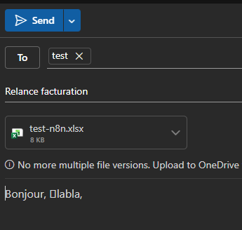

hmmm, while I don’t like code nodes, I was curious about this issue, so I generated some test data since I don’t exactly know what type of files you’re trying to attach, or whether the code might be corrupting the file,
your attached workflow works fine btw with some test data and with an Excel file as an attachment:
So, to save you some time, at this point the issue is most likely related to the binary files,
Also, the Code node is running in “Run Once for All Items” mode, which I think could also cause issues when working with binary,
so as I mentioned, if I were to do this I wouldn’t use a Code node,
Instead, I’d use a Set node with a binary field with Merge/Aggregate nodes, this should give the same result I think..

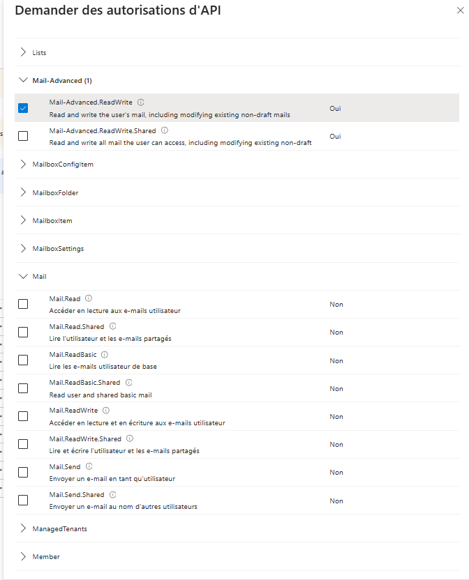

HI, I tried a simple way (only a excelsheet, no code), but the same error. So is it possible that the pb is from credential aspect ?

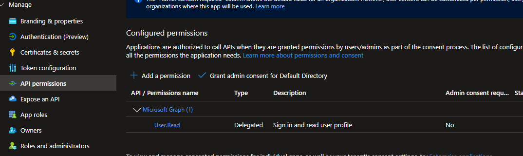

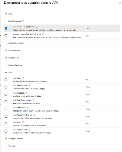

When I look at API authentication via Microsoft Graph for N8N, what permissions are needed to attach a document to a DRAFT Email - Resource DRAFT (it’s working to send an email with attached documents - Resource : MESSAGE, not to attach a document in a draft email - Resource : DRAFT)?
hmm, these are the permissions I see in my app:
I don’t remember doing anything specific,
Everything was pretty straightforward, I just followed the docs exactly from here:
