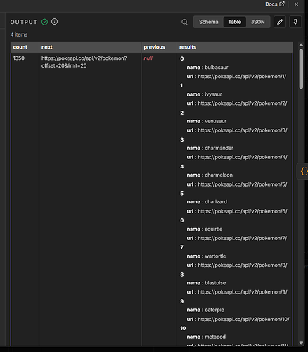

Hello @kryten4b . As @John_Rager explained, you might be seeing something like the following:

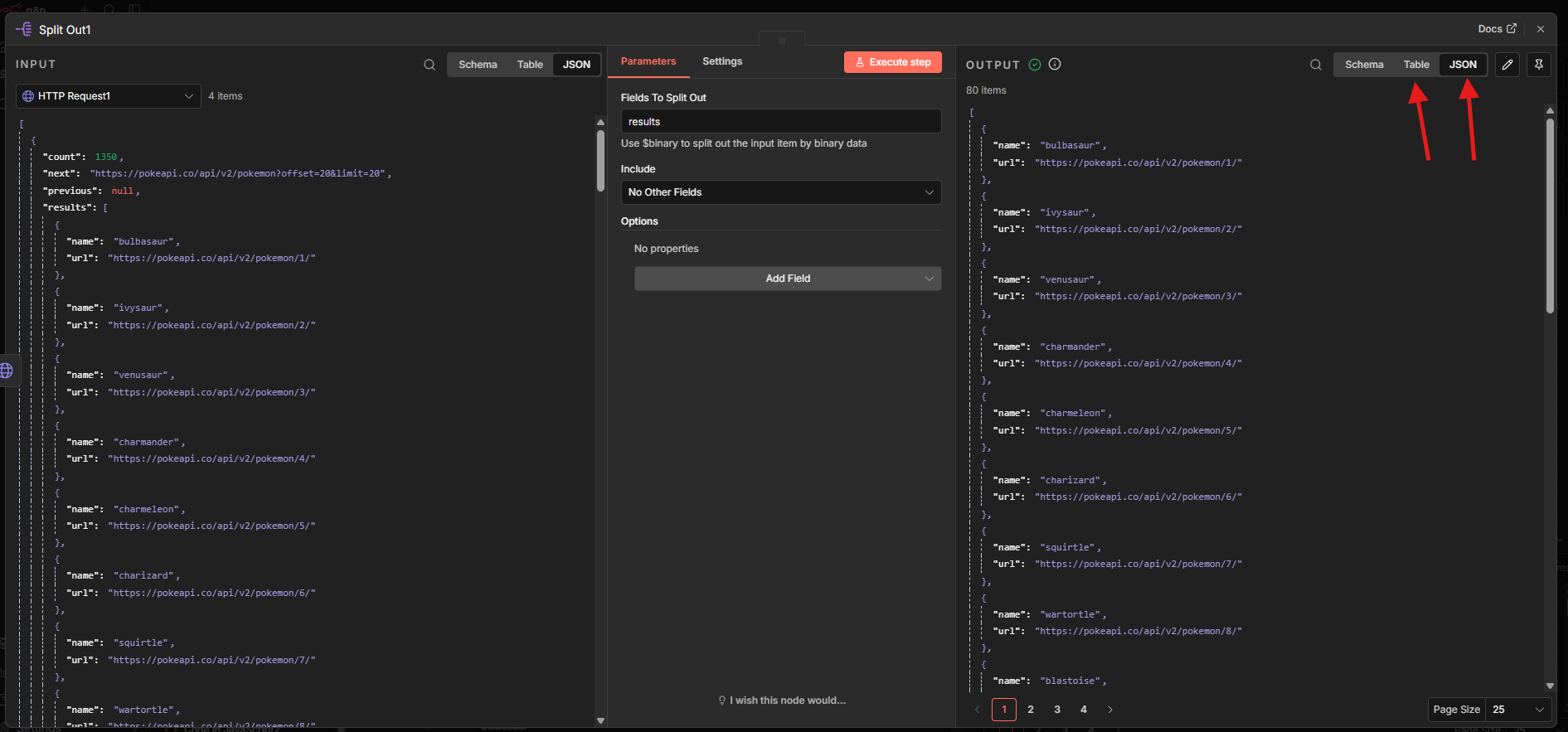

this is the representation in the n8n UI. but if you check the JSON option (marked on the image), you will be able to see the actual structure:

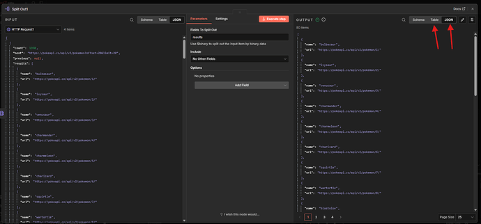

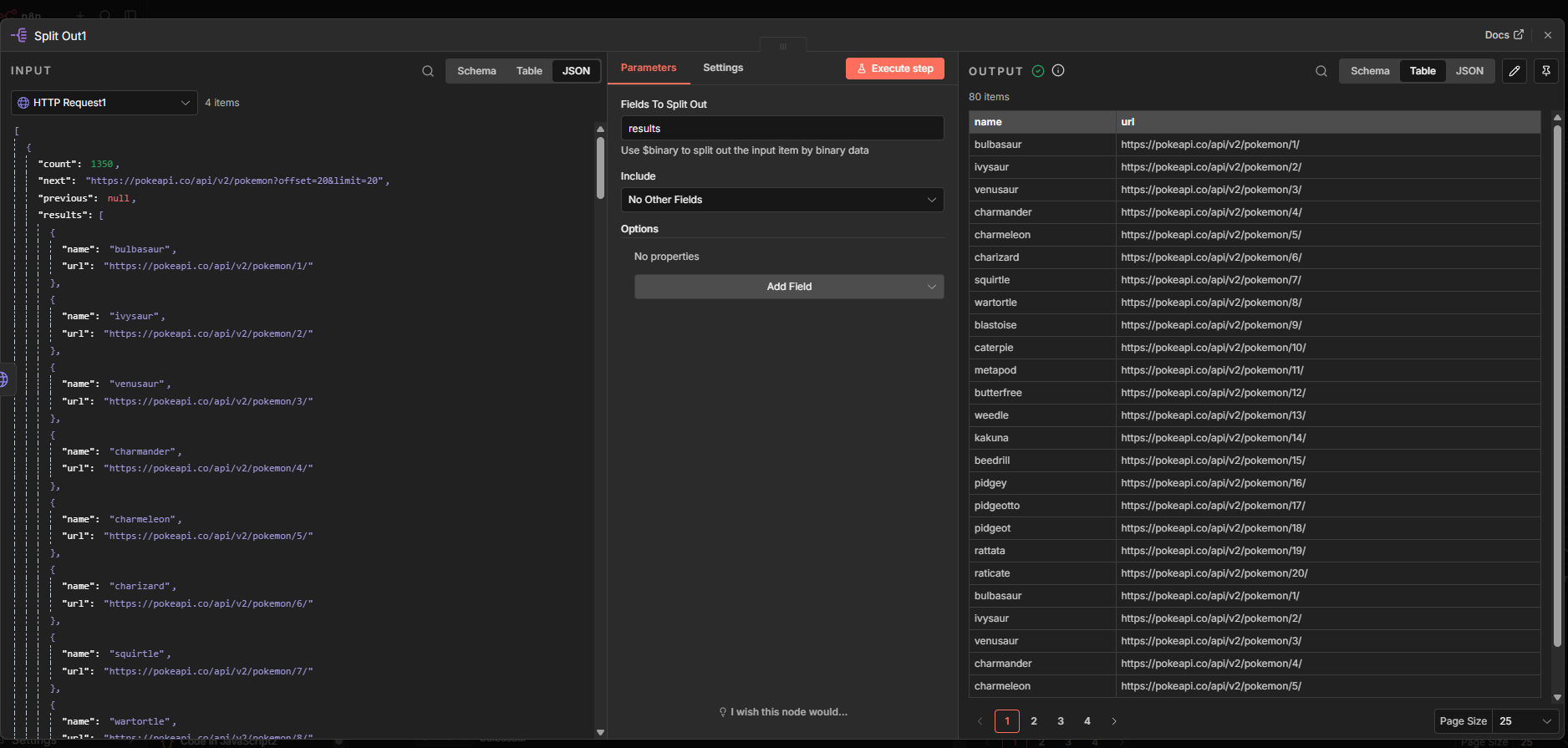

If the table is showing something like the following:
Then you can use the Split Out node or code to separate it.

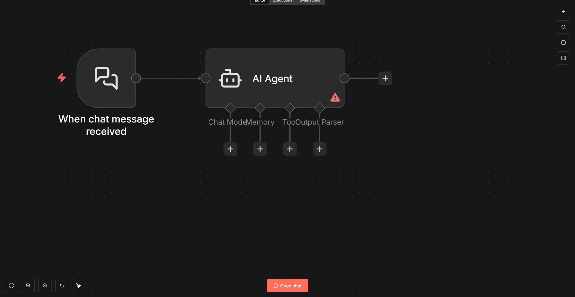

What you are facing is the uncontrolled output of the AI agent, for controlling or giving a specific output instructions to the AI agent you probably need to check this option in the AI Agent:
And once this is checked you would see another field for a specific output in the AI Agent:
As you can see fourth option you can now click on the Output Parse and select these options:
I recommend using Structured Output Parser as you can provide a JSON format that the AI agent would follow, And there you can add your specific required output and AI would follow that, just in case if this breaks in prodution you can use Auto-Fixing Output Parser which connects an AI model to always check before giving the output.
