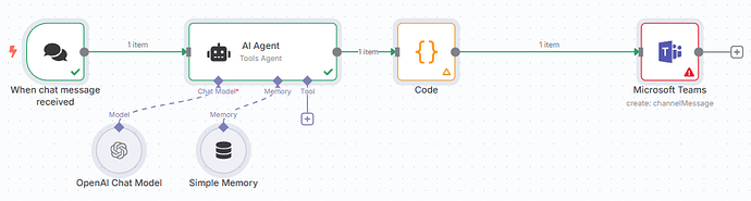

Snapshot of the workflow as below

The AI Agent output is correct it is a combination of Explaination (simple english test) and the sql codeblock (CREATE TABLE STATEMENTS multiple) and the summary(in plain english). All I want is the CREATE statements, I want to to leave the rest so that I can execute in a db. I used .replace but it says it is not supported, I used filter as well but of no effect.
Hi,
How can anybody troubleshoot that of 2 screenshots which don’t show all the Info.
Reg,
J.

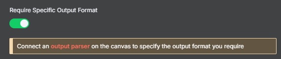

Hi @Sreekanth_Yedla
I think you need to integrate Structured Output Parser into your AI Agent
and define a Schema that suits your needs…
