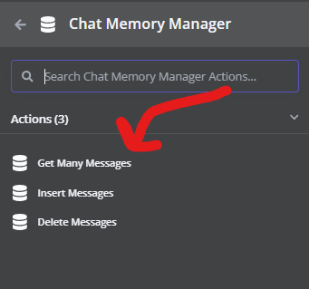

I this case you could use the “Chat memory manager node”.
It has the option the retrieve messages, without altering the chat history.
Just give the session_id it’s going to use to retrieve the correct chat session.
