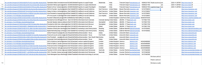

I have my workflow append the final info into google sheets. It work most of the time, but sometimes the info just won’t append/update on the google sheets cell. This is a persistent issue over a large dataset of items (tens of thousands) with probably 1/20th of that having this issue. So it’s a significant problem. The actual issue seems to occur for a number of cells (10-20ish) then resolves itself. It also appears to randomly just happen at any given moment as I have some cells that remain blank as just one offs.

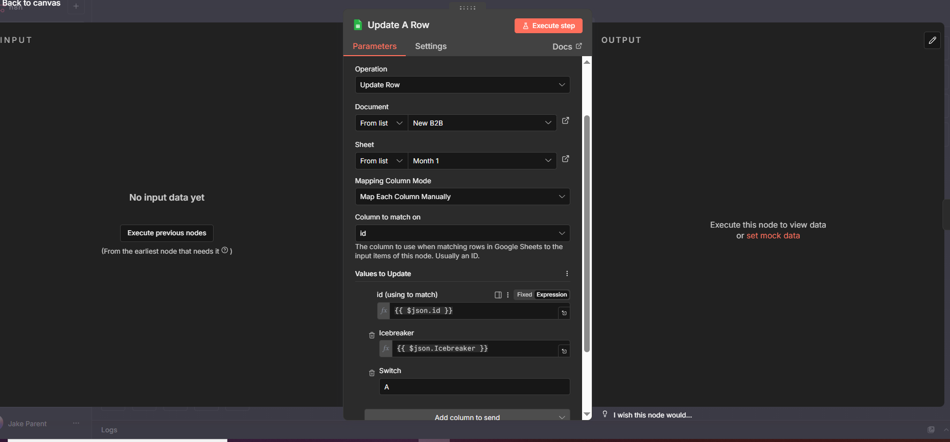

I get character capped when I try to paste my node. It also does not accept the standard downloaded JSON file? what’s up with that. Here’s a screenshot at least of the node, and the missing output. You can see that it just seems to not work for a number of rows then picks backup.
