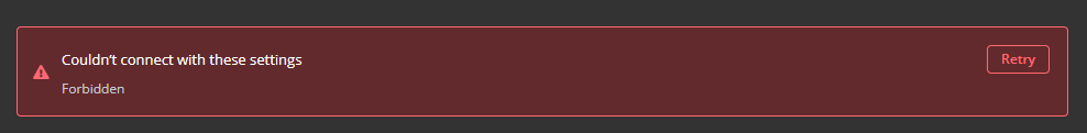

I am trying to connect to Pinecone. This is my first setup with pinecone. When I enter the API Key, I receive below error message.
It works with the same API Key on the cloud version, so it has to do something with the installation. However this is a fresh install of the Community edition.

Forbidden means you are doing something wrong (wrong key/api url/token/etc). Check the docs:

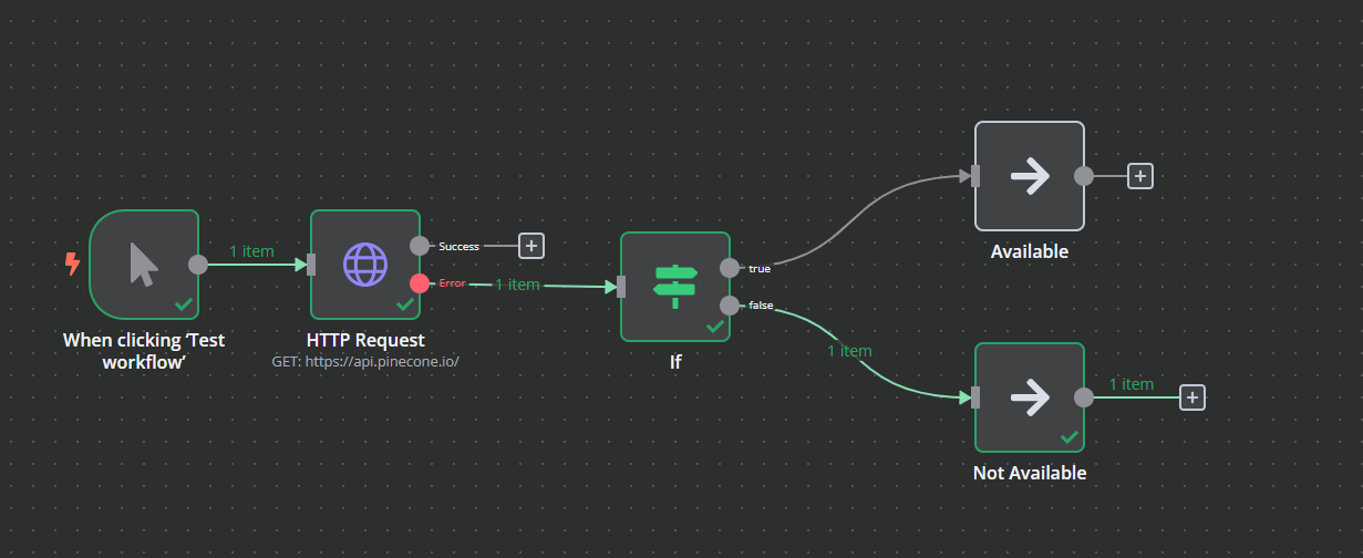

Well, another option - pinecone is not available from Hetzner.
Can you please check that the site is working with that workflow (just copy and run it)?

I mean the pinecone url may be blocked from specific platforms. That’s why I’ve asked to check the availability with the above workflow
Hi
Seems to be successfull:
Still the connection to Pinecone is failing with the same error… it’s somehow kind of frustrating, since this is a completely fresh install…

According to the screen, the connection was NOT successful. It means the pinecone site is not available from Hetzner and you can’t connect to the pinecone from it
