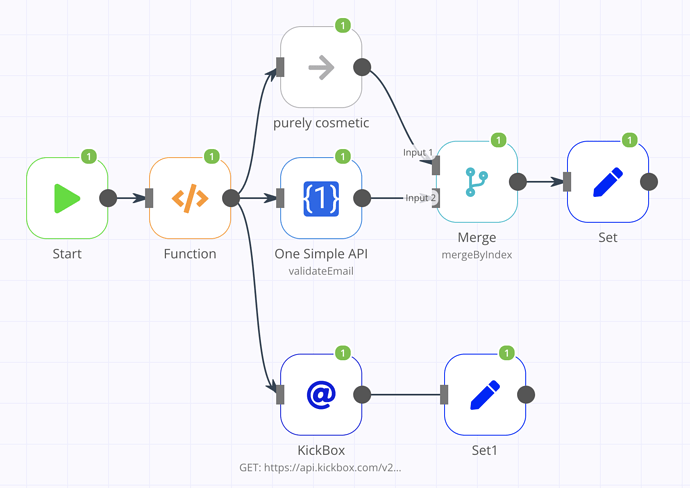

Hey @Sathya_Narayanan,
I have popped together a quick worklfow to show how to use OneSimpleAPI and Kickbox through the HTTP Request Node.
The function node just returns 4 emails address that both services will use, Because OneSimpleAPI doesn’t return the domain (Just put in a feature request with the chap that makes it) we use the Merge node to join it up then the set node at the end to just return the Domain and Disposable result.
On the bottom part we use the same email addresses then use the HTTP Request node to call Kickbox then we use the set node to return the 2 columns.
Example Workflow
Hopefully this helps :+1:
Quick update…
The change to OneSimpleAPI has happened so now the response has everything needed, New workflow is below that shows both options.
The API change doesn’t require any changes to n8n it was a backend change and I would like to thank Pablius for being so quick :smiley:
Example Workflow
