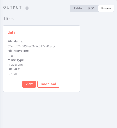

Can you show the output of your step “Edit Image”?
Absolutely. Here are the JSON and Binary outputs.
Screenshot 2023-02-17 at 10.10.52 AM
I just realized that if I move the Upload step right after the Edit Image step, then this works. I have concerns doing it this way since I would then need to put the Auth step before the Get Image Template step and the authorization is based on time. If I have a large file, the authorization could expire before we get to the upload step.
