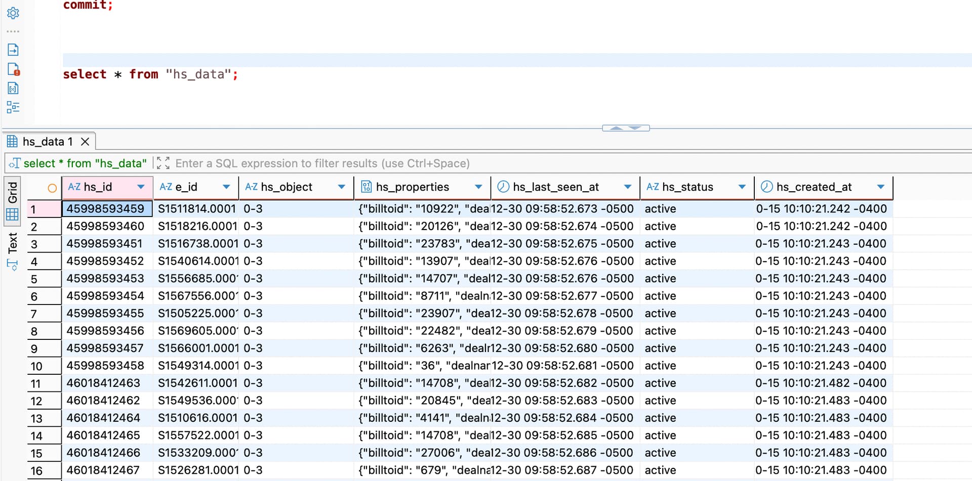

I’m aggregating data from an http query to hubspot in a postgresql table.
Read data → store in table → check if more pages → read data starting where it left off → etc.
It slows down significantly after each subsequent run, and slows basically to a halt after the 4th run. It’s only getting 200 records from HS each time. Here’s a video of what that looks like.
I am fairly sure this is happening because n8n is running the PostgreSQL node on all data each time, rather than just the data from that loop. so by the 3rd run its running on 600 records instead of just the 200.
How can i prevent it from accumulating data each loop?

Here’s what the data looks like in the table:
