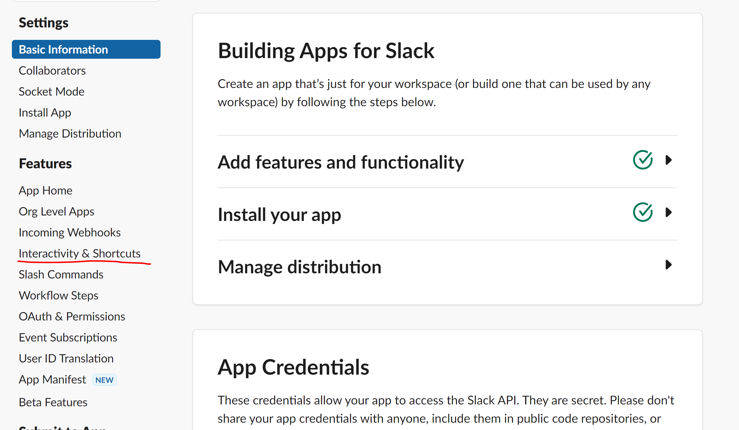

As I don’t know the Slack api that good I could just give advise to create the slash command to mark a message. But actually I don’t know yet how to get the reference. I just saw I my Slack recently that it is possible to create message actions. Maybe thats something for you as well. (See picture)

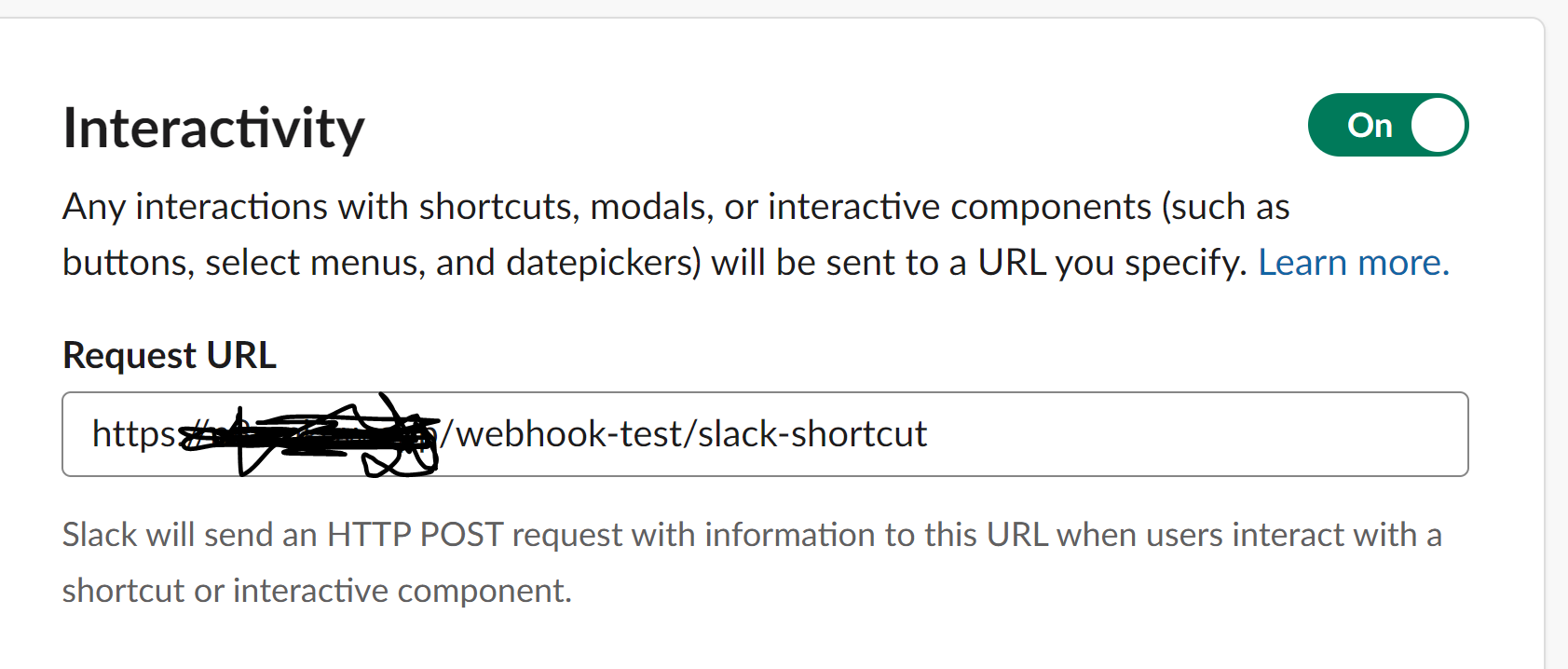

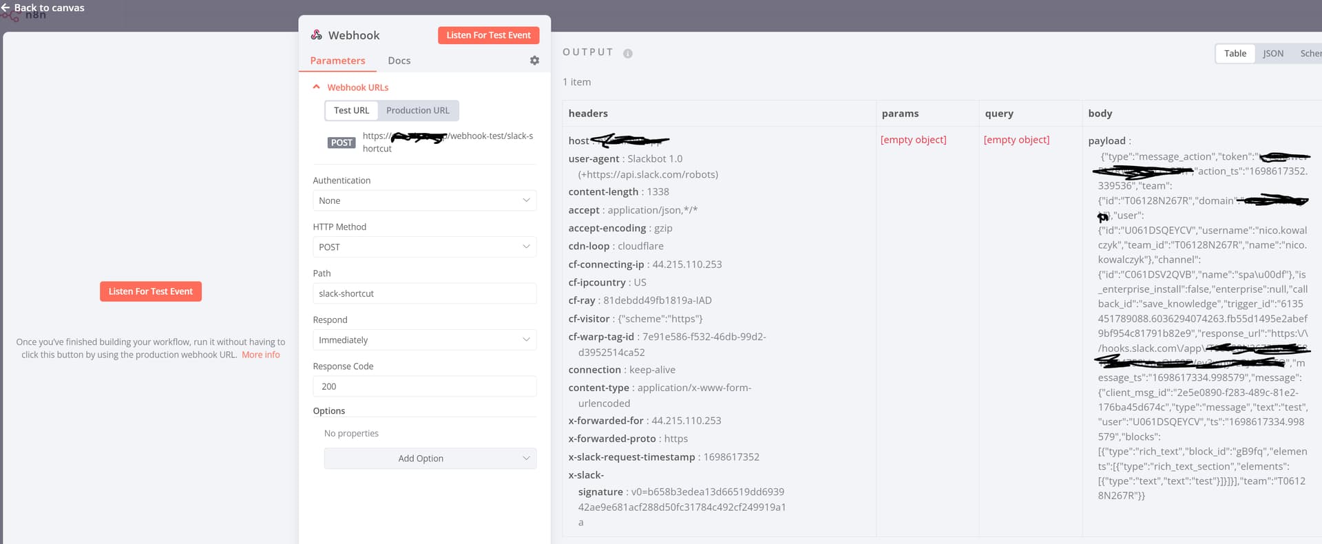

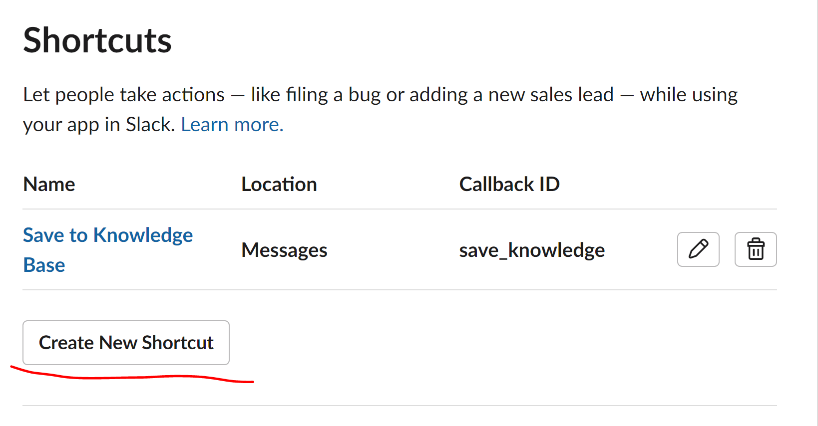

Okay that was really nice actually.
This triggers the workflow via webhook.
That could be a real-time solution for you created with n8n without having to analyse all events.
In the Slack app settings yo uneed to go to shortcuts:
Works like a charm.
