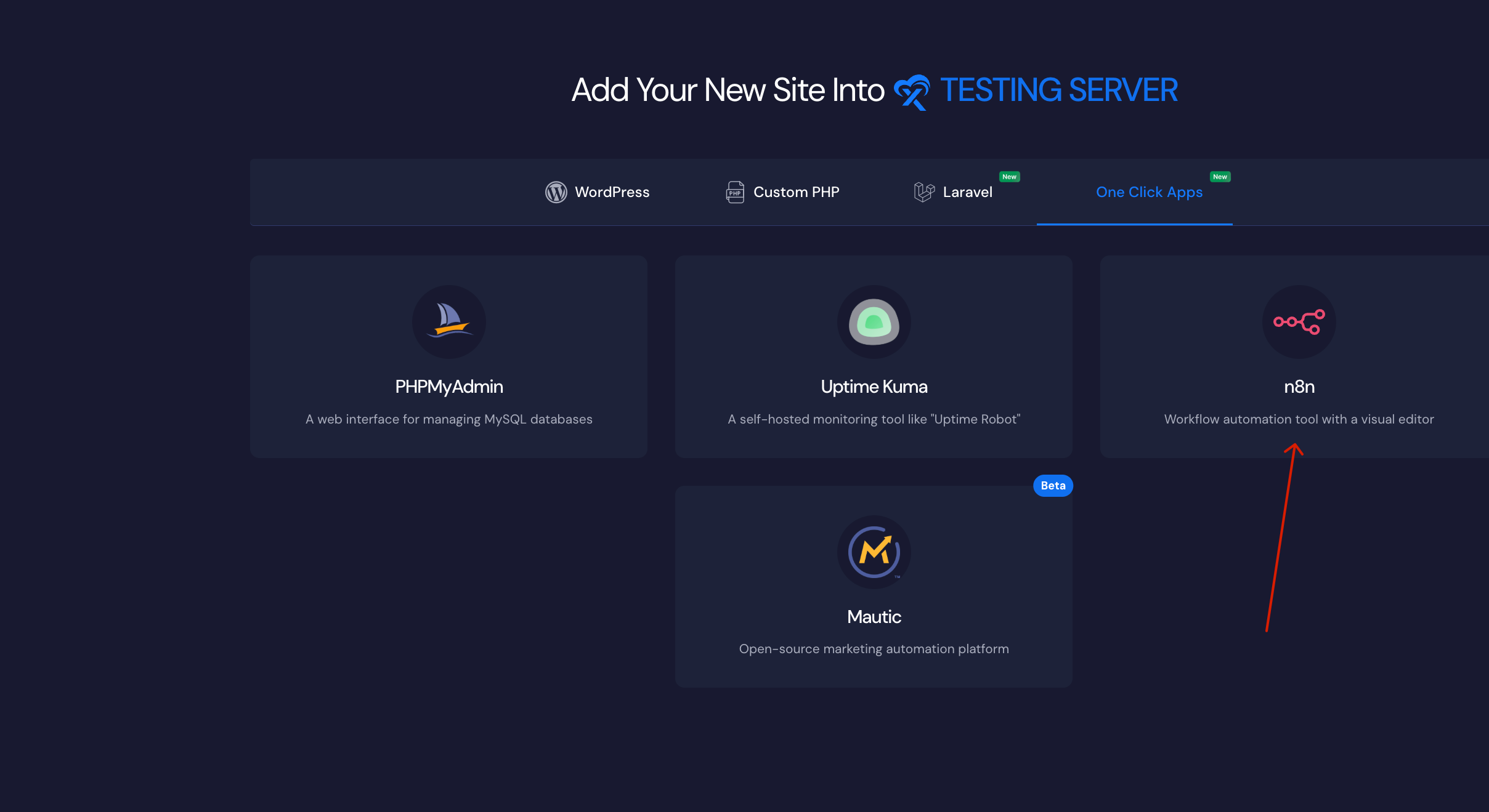

I’m running a self-hosted n8n instance on a cloud server on xcloud.host .
It works great, but I have an issue during updates.
