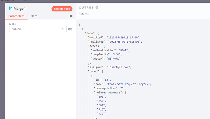

I have this flow, here’s part of it
Now, this node:
keeps giving me this error
Its the same as the node above it which works ok, making the same calls etc and there are results coming from if IF node, I tried adding a no op after true false as I’ve seen that bug before, but it didn’t help.
I have no idea why it thinks there is no output from the node before?

From taking a first look it seems this could be related to the HTTP Request not returning valid JSON for all URLs you’re calling. As a workaround you could set the Response Format to String:
n8n will still understand the JSON response (but will move it under the data key, so you might need to adjust the following nodes a little), but would no longer complain about the non-JSON items:
ahh interesting, the error message was less than useful, but that makes sense. cheers will give it a go.
yeah that allowed me to pull back the data, thanks.
