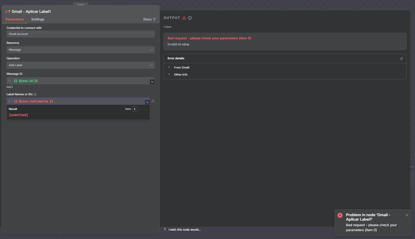

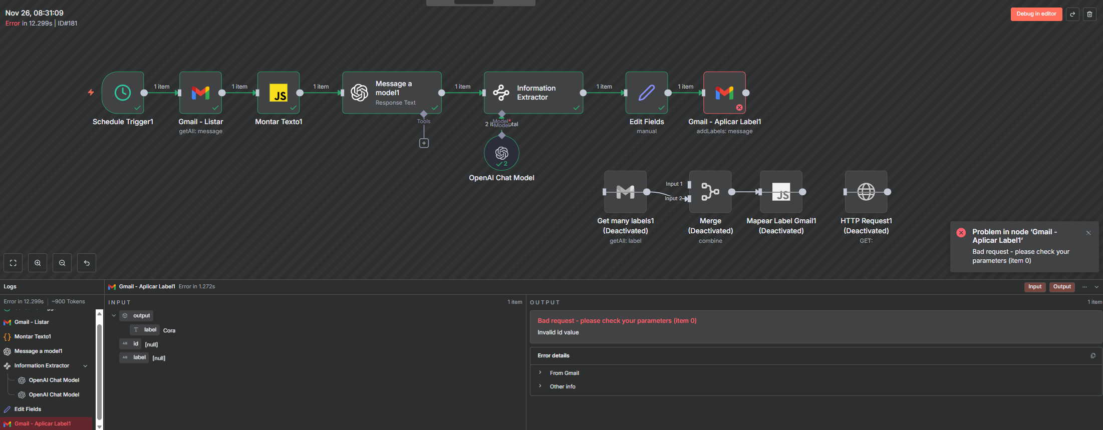

I’ve been trying for over 4 days to use every possible option to create an automation using GET LABEL GMAIL, and it simply doesn’t work, regardless of the solutions I use, which have been dozens and dozens, with changes to code, flows, etc., and nothing changes, nothing solves the problem of “Problem in node ‘Gmail - Apply Label’
Bad request - please check your parameters (item 0),” or it not finding the ID that arrives correctly in all nodes. How do I solve this?

Please post your workflow or a test case or DM me.
Did you send the correct label ID?
Já tentei de absolutamente tudo. Mas não funciona. Agradeceria muito se conseguisse me ajudar
Your formula for label names or Id is wrong. it is red and result in undefined
