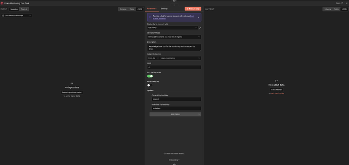

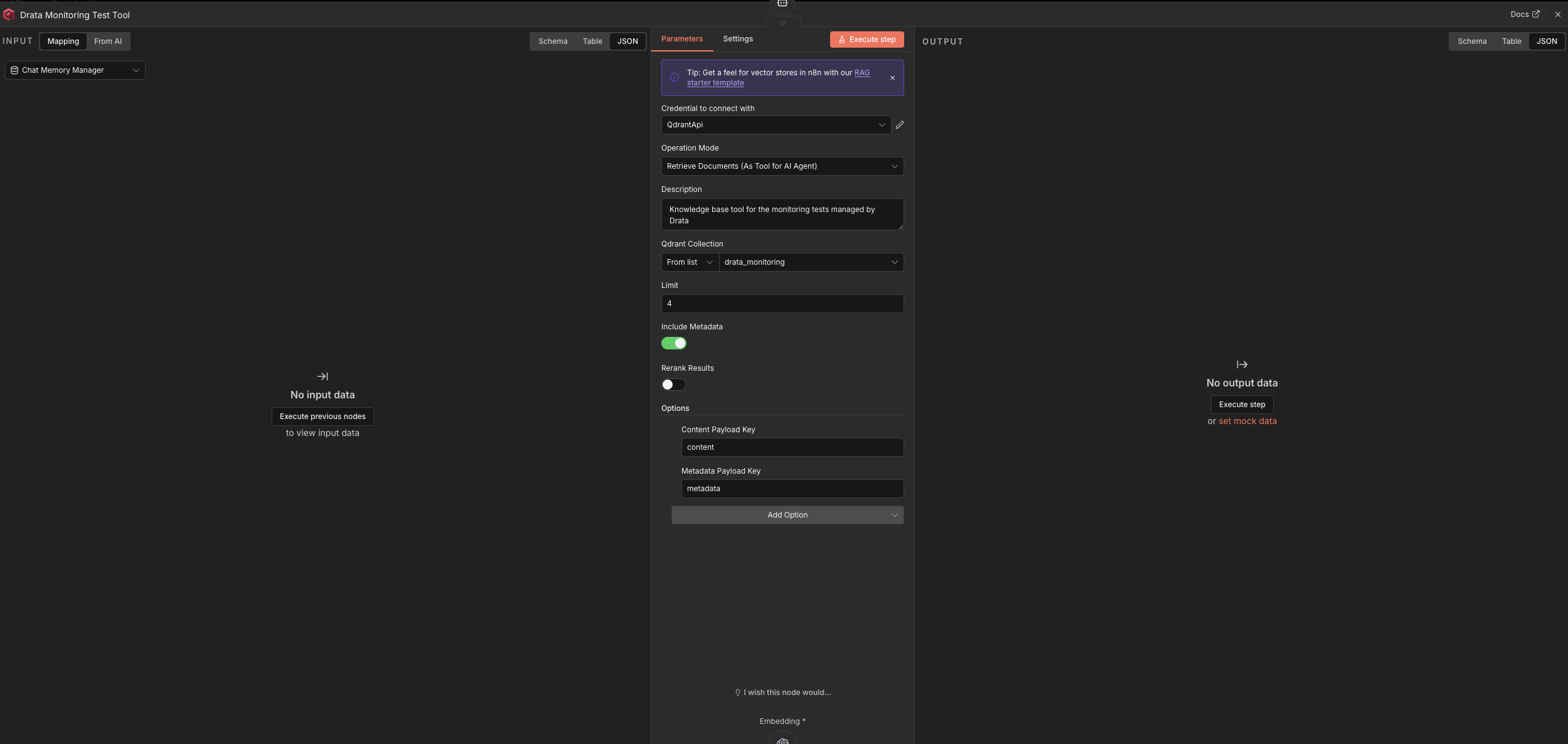

Drata Monitoring Test Tool is a Qdrant Vector Store node which looks like:

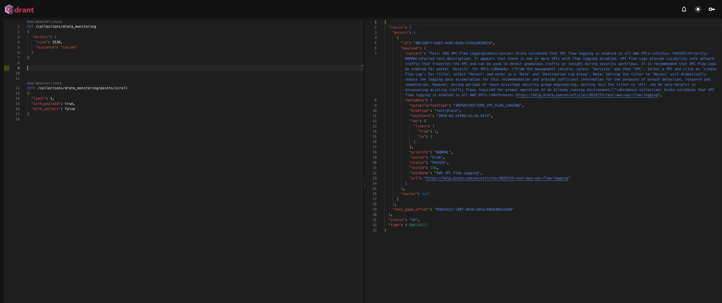

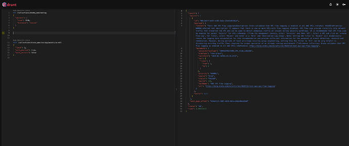

This is how the data looks in Qdrant:

Hi @hoiyothaheem
Thank you for trying to debug the flow.
I have checked all the items that you mentioned in your response.
Qdrant Vector Store mode
:white_check_mark:
Check if Qdrant has data
:white_check_mark:
Embeddings model match
:white_check_mark:
Try without Memory first
:white_check_mark:
Check n8n version
  • n8n version: Version 2.3.4
  • Qdrant Version: 1.9.5
Retrieve Documents (As Tool for AI Agent)
