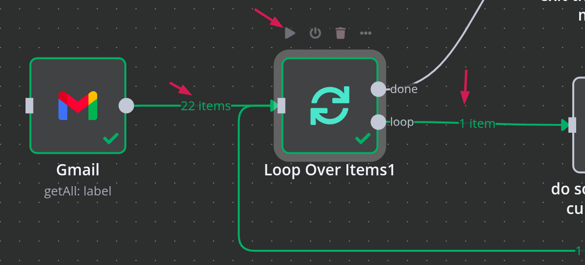

Sounds like the split in batch/ loop node is exactly what you need. You just have to loop around back to it after you finish processing each record
Just keep in mind the Loop will go through all records only if it is a real execution of an enabled workflow
When you are manually testing the node it only processes 1 record

For me the node looks like this but it says (Split In Batches) in brackets so i guess it has been modified and renamed at some point.
Oh ok it has renamed in the new version Split in Batches
