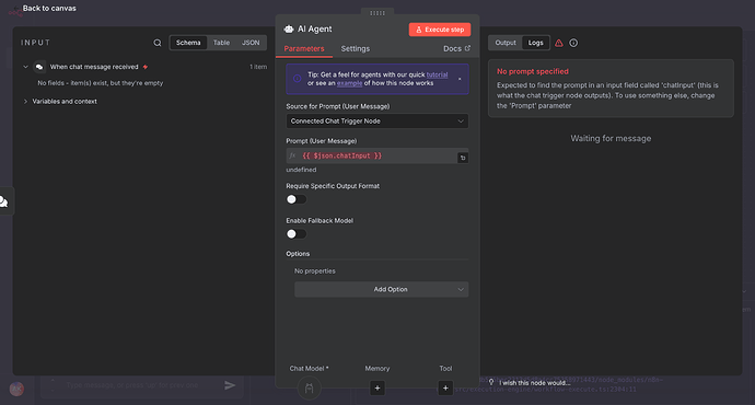

The issue appears only when using Ollama Chat Model or LLM Chain
Problem:

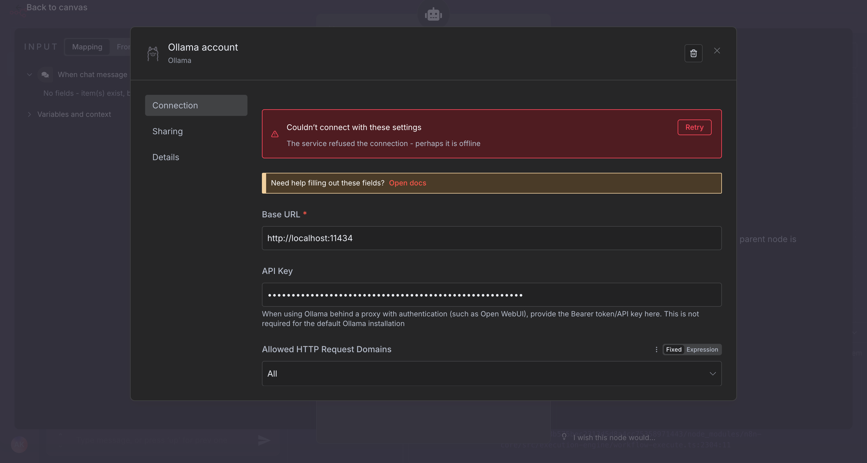

When I remove the “API Key” field from the LLM nodes (because Ollama is local and doesn’t require one), n8n throws a connection error:
“The resource you are requesting could not be found” (404)
Or sometimes Ollama returns “Ollama running” on a GET request, and POST is rejected
As a result, the Ollama Chat Model node cannot connect to any upstream chain, and LLM Chain node breaks completely

Question:
What is the correct way to configure the Ollama Chat Model (or LLM Chain) in n8n 1.114.0 so it works with a local Ollama instance without requiring an API key?
Do I need:
a specific base URL format?
a custom header?
a separate LLM agent configuration?
a workaround for the 404 / GET–POST mismatch?
