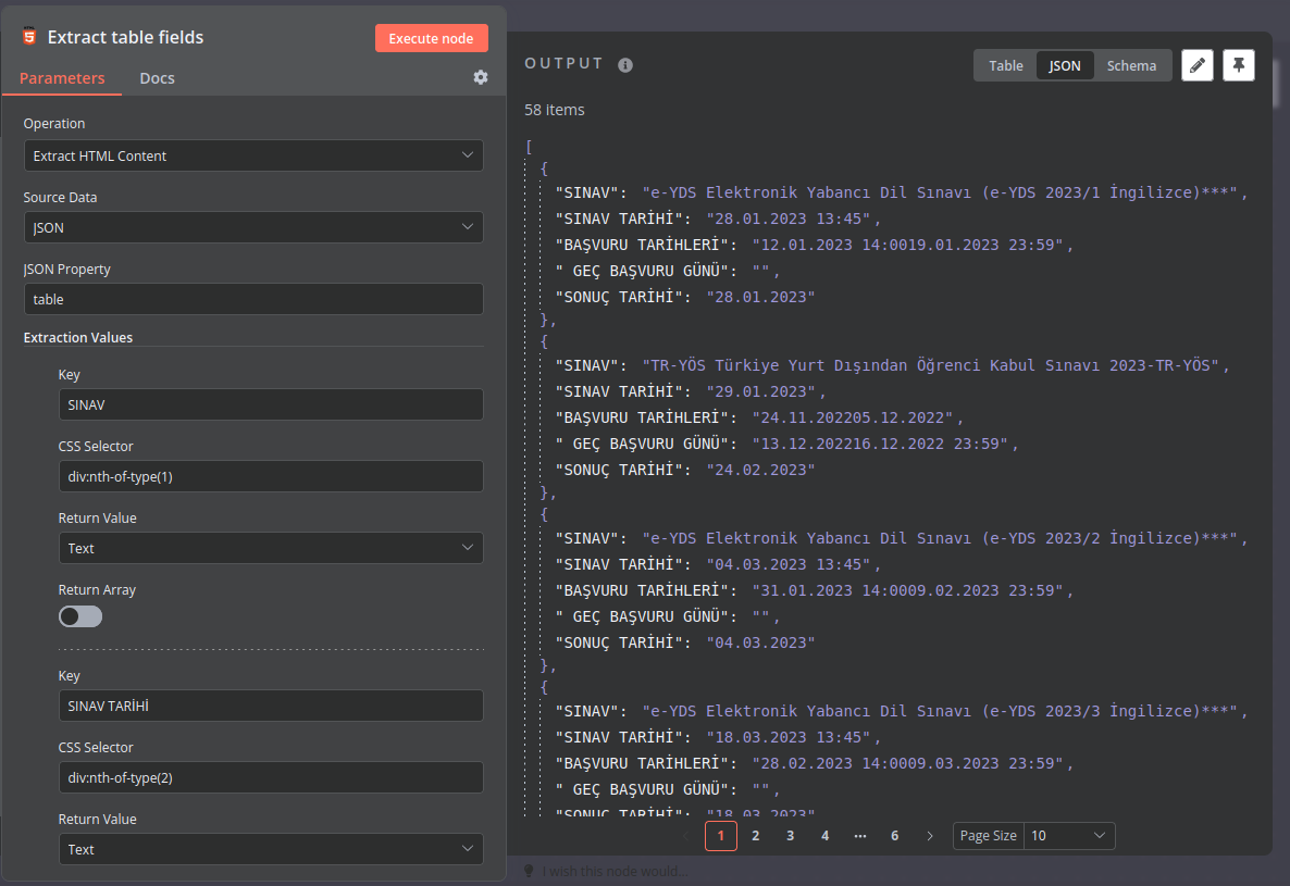

If you’d rather tackle this yourself it seems to me you’d want to first fetch the page using the HTTP Request node, then process the content using the HTML node, parse dates as needed using suitable Luxon expressions in the Set node, and finally insert the data using the Google Calendar node.
Seeing the HTML part can often be the hardest, here’s a quick snippet to get you started:
It will extract the table data and will make it available inside n8n like so:
