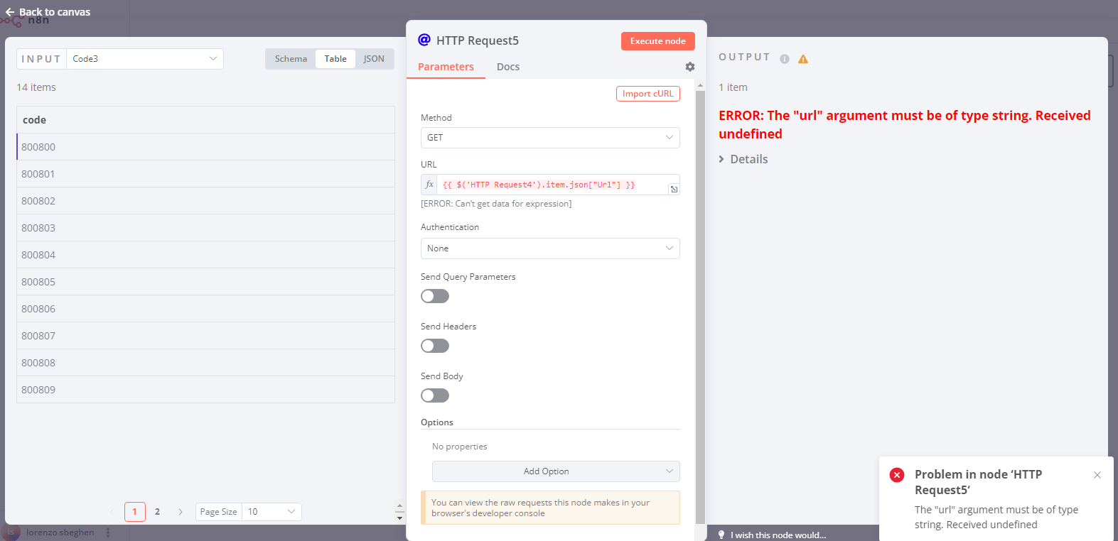

Problem with expression in the HTTP request node

Hi @LorenzoSbeghen - thanks for that! As your workflow requires credentials I wouldn’t have, I can’t run the workflow to get an actual example JSON. But I’m wondering if perhaps you have more than one item being returned, or an item doesn’t have a URL set?

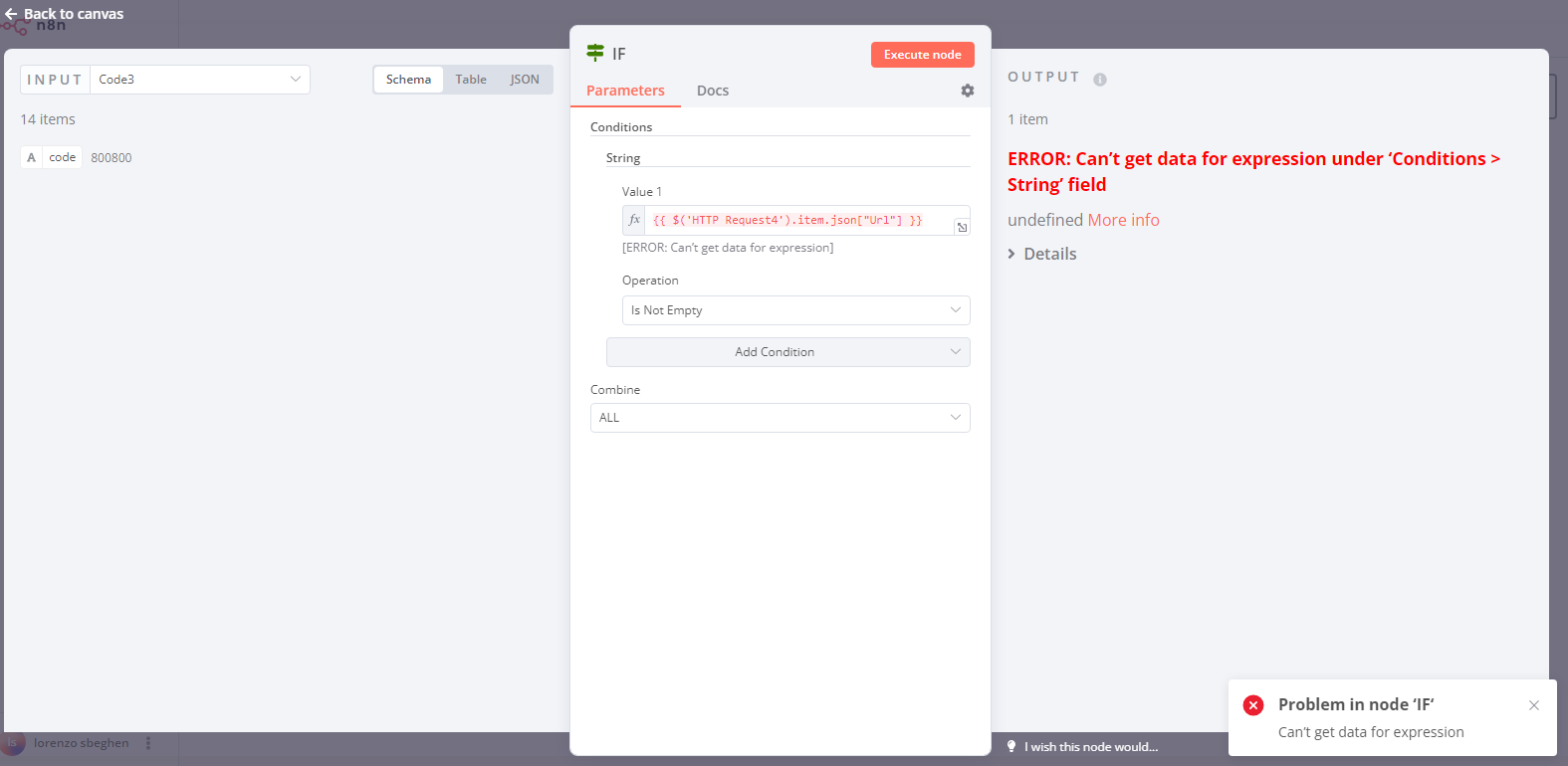

You could add an If node before the HTTP Request Node 5, that looks like this:
You could then see if it’s missing data :+1:

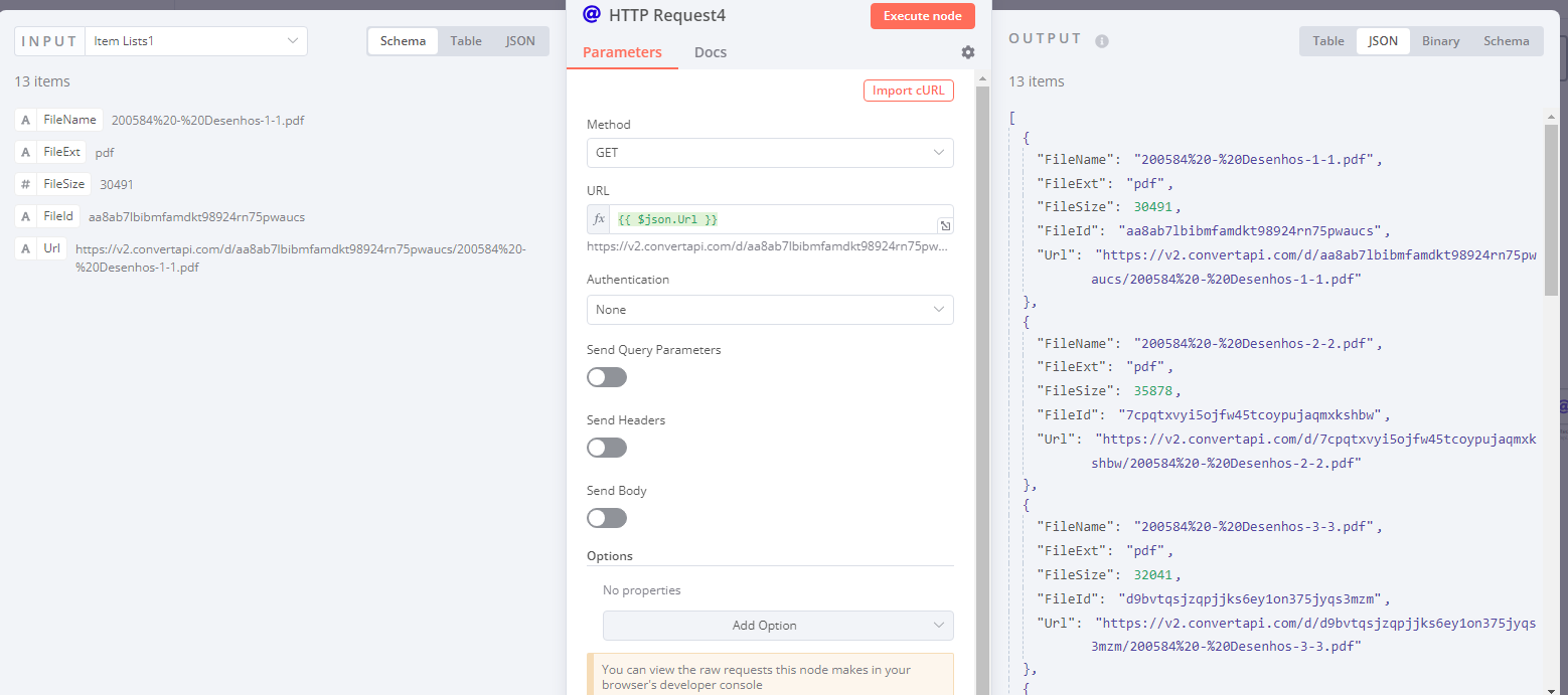

all have url
Ah, that actually highlighted the problem - you either will need to add the item index to the Code node output, or out of HTTP Request 4, you’ll need to Split in Batches and process one at a time.

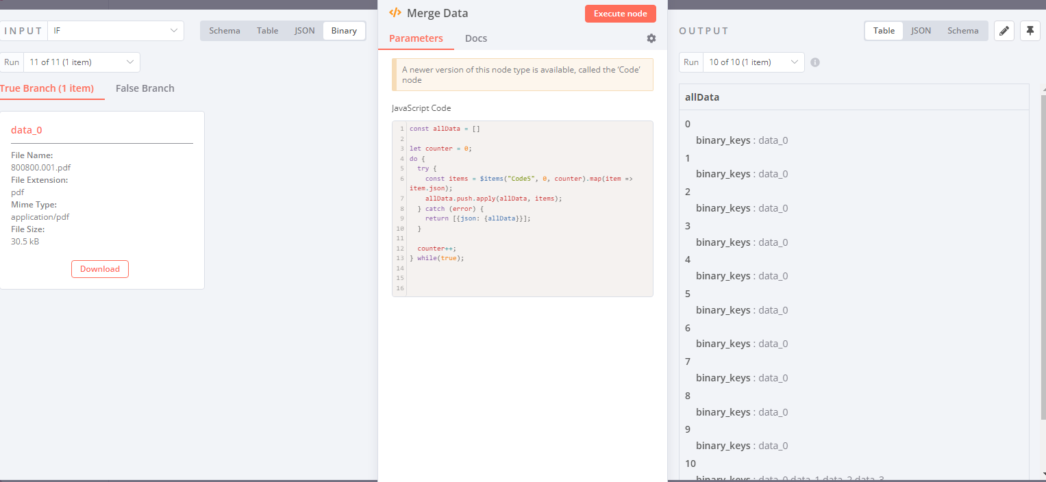

Try putting the merge from the done branch on the split in batches node, You may not even need the code node depending on what you are doing. Check out the example below and see if it helps.
