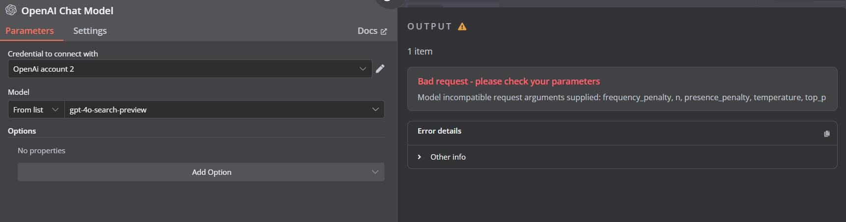

Hello everyone,
I encountered an issue when using the OpenAI Chat Model node with the model gpt-4o-search-preview. I get the following error:
Model incompatible request arguments supplied: frequency_penalty, n, presence_penalty, temperature, top_p
However, I’m not providing any of these parameters in my node. I suspect that this model does not support some of the default arguments.
Therefore, I would like to create my own custom Language Model using the LangChain Code node in order to have better control over the parameters. Could someone please provide me with a complete code example for calling the gpt4o (or gpt-4o-search-preview) model via the LangChain Code node?
I need to know exactly what to include in the code of my LangChain Code node to use it correctly.
Thank you very much for your help!
