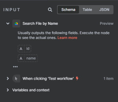

Thanks for your answer but that’s exactly where my problem lies. If I unchecked “Always Output Data” on google drive node there isn’t any id or I can use json code that you provide.
Here’s the screenshot between the “Always Output Data” on and off
From the always output data on the condition (with json code) colored red that’s why I hardcoded with the file name previously.
And if I doesn’t checked the “Always Output Data” option it will stop the workflow and that’s why I’m stuck because both option is lead to failure.
In the IF node, instead of using {{ $ json.id}} with the “exists” operator, try changing the condition like this:
string {{ $json.id || '' }}
operator: "is empty"
If the file exists → id is a string → {{ $json.id || '' }} returns the ID → so it is not empty
If the file does not exist, even with “Always show data” active → id is undefined → the formula returns '' → is empty
It works now. Thanks for the help :handshake:
