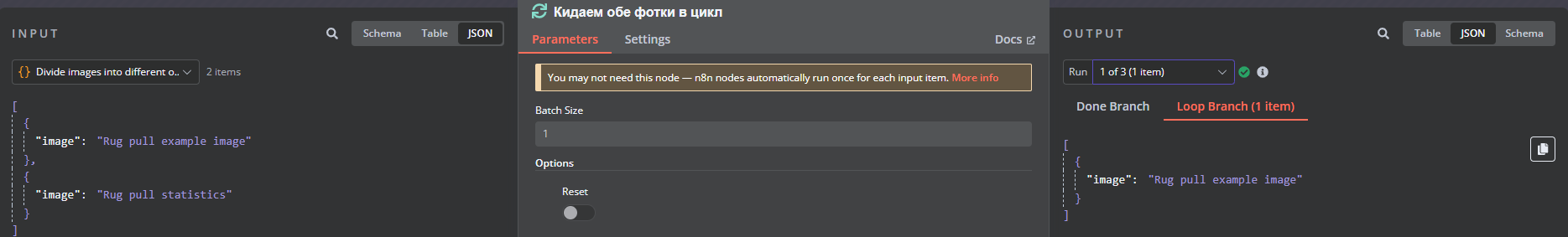

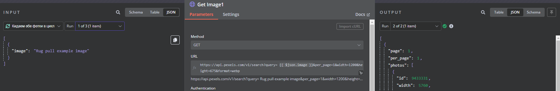

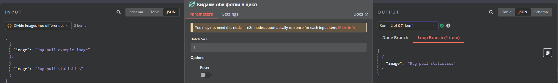

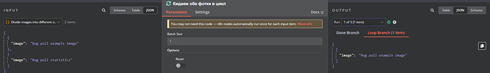

The problem is so: When i give into the cycle two different images, on the output of the cycle node there is the first image for the first run and the second image for the second run, but when I move to the next node there is the first image for both first and second run of the cycle on the input of the node.
Cycle node on the output:
First run:
Second run:
Cycle node on the input of the next node:
First run:
Second run:
