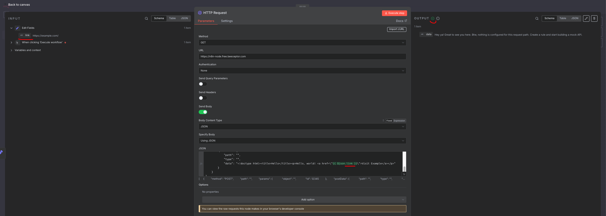

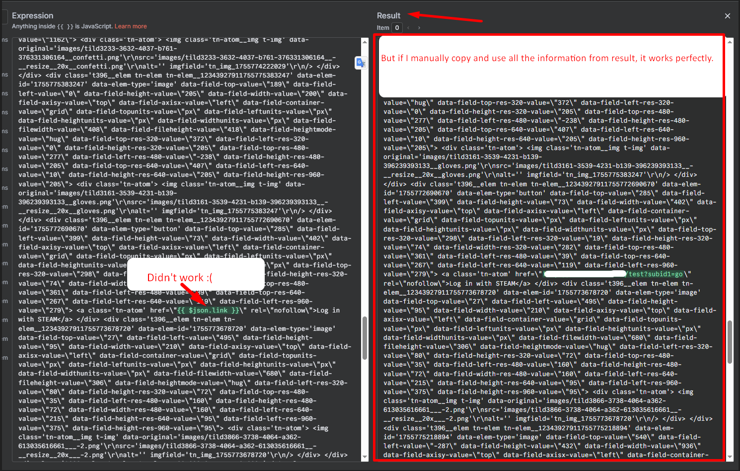

    When making a POST request with a JSON body, I refer to the previous data to insert the link {{ $json.link }} into the body.
    The problem is that when I use {{ $json.link }} I get the error “JSON parameter needs to be valid JSON [item 0]”.
    But if I manually insert the link instead of {{ $json.link }},
    the request is executed successfully. What could be the problem?

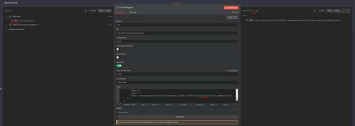

Inside the body request
“data”: "*page html code*”
*page html code* contains:
href="{{ $json.link }}"
Where
{{ $json.link }} = https://example.com/
In this way, I’m getting error in POST response:
href="https://example.com"
Everything works fine

This solution did not help :frowning:
In this case, where
{{ $json.link }} = https://example.com, the solution returns the error “JSON parameter needs to be valid JSON [item 0]”.
