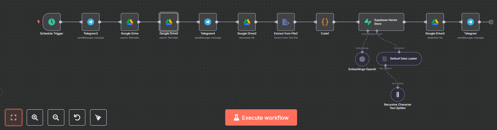

Task - Upload information on the product directory from a txt file to the supabase database (tab-separated text, 4 fields in each line: code, name, manufacturer, country). I disassemble the line with the entry into parts, place the product code in the metadata, write the line with the name and manufacturer to the content.

I already split the source file into 752 parts, parts with 1000 lines… I also tried to upload one file at a time (once per minute).

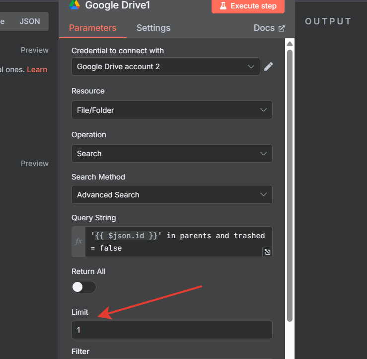

Another Workflow, which accesses the GDrive directory, and uploads only one file (limitation in the node).
After uploading to the supabase, I deleted this file in GDrive.
With small files used for rpimar (10 lines) - everything is ok.
With files of 1000 lines, there is a problem… All stages are performed, data is uploaded to the database, the file is deleted from GDrive after loading, but the Workflow process does not stop, it continues to hang active.
In the first Workflow with a cycle, it feels like the memory is overflowing, in the second variant with deletion, it seems that GDrive does not report the end of file deletion (after deleting the file at the last stage, for verification, I send myself a message to the bot about the completion. On files with 1000 lines, ~100 Kb - confirmations do not come).
