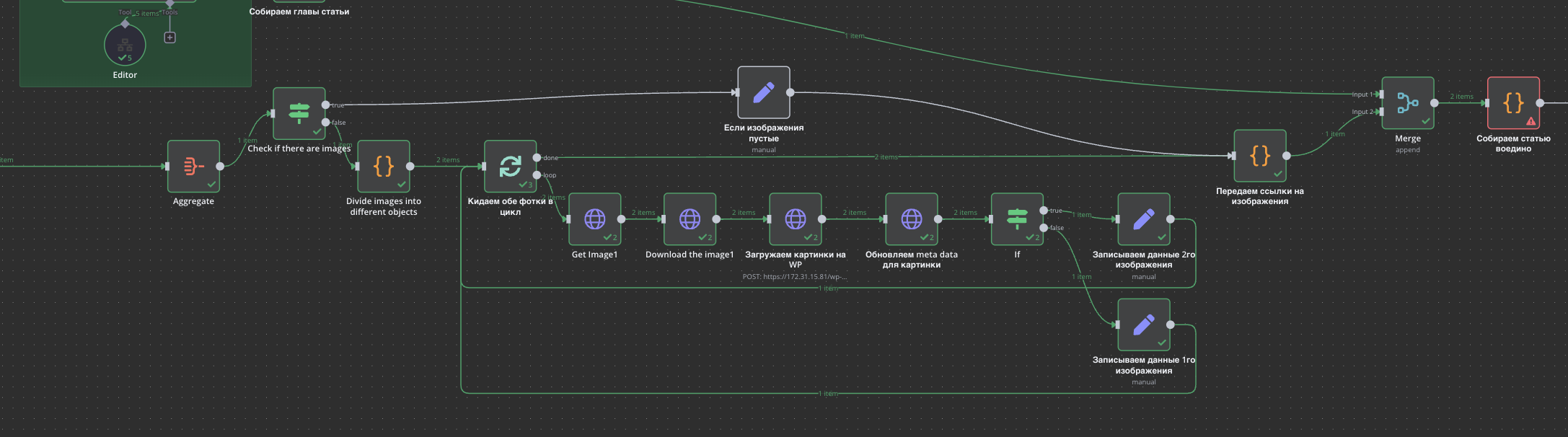

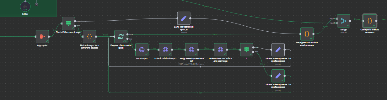

  • Here is the whole scheme.
Here is the part after Merge
Here is the example of the output of the Merge:
