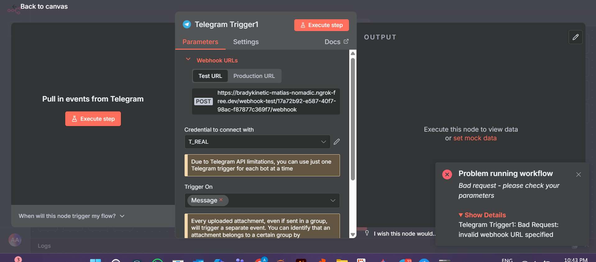

Problem with Telegram Webhook After tunneling with nGrok
Hello everyone,
I have been using tunneling service from nGrok to publicly accessible the telegram webhook to my n8n. after doing every step even properly and also in docker i have set the env and WEBHOOK_URL just according to the link .dev i got from nGrok to my docker container in the same host as well the nGrok is running. but still error in the parameter. I cant execeute the step at any cost. Please Someone generous enough to help me.

It looks like you’re having trouble getting your Telegram webhook to work with n8n and ngrok. The most common issue is the `WEBHOOK_URL` environment variable not being set up correctly in your Docker container.
1. **Verify the URL:** Double-check that the `WEBHOOK_URL` in your Docker environment variables matches the ngrok URL exactly, including `https://` and any specific path if you’ve set one.
2. **Restart n8n:** After changing the environment variable, restart your n8n Docker container to ensure the changes take effect.
Give that a shot.
