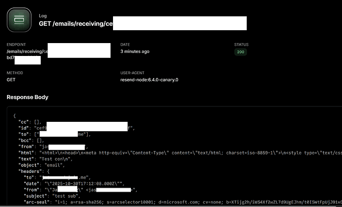

However, from RESEND portal, I can see it’s delivered message body.

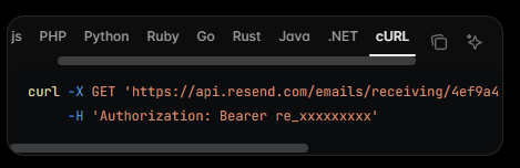

No problem. I’d just recommend not using the Execute Command or even the Code node unless there’s something you can’t achieve with a simple HTTP request, which is possible most of the time.
In your case, you can simply call this endpoint to retrieve received email without running any commands, writing custom code, or installing any libraries in the n8n image:
as you can see they are supporting cURL:
omg, you saved me…I didn’t realize the last option to use CURL which make thing much more easier. Now I’ve got the JSON……Will figure out the way to parse the outlook, especially converting HTML to text…….If possible, can you give me some hints on using which kind of node…

using CURL even don require install custom library……thanks so much
