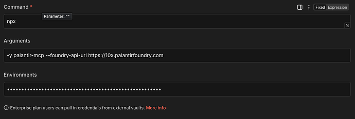

I am trying to integrate the palantir-mcp in a mcp-client community node as this supports only STDIO for authentication. I enter the credentials as shown in the image below. I tried installing the palantir-mcp globally in the docker image running n8n but that did not help as well.
Problem in node ‘MCP Client‘
Failed to execute operation: The file or directory does not exist
For now I just have a trigger which is on click and it executes the get available tools from the mcp server

This error (The file or directory does not exist) is extremely misleading. It sounds like n8n can’t find a file you uploaded, but usually, it just means the node cannot find the npx command itself.
Even if npx works when you SSH into the container, the n8n node runs in a restricted environment that doesn’t always have the same “PATH” variable (the list of folders where the system looks for tools).
** Quick FiX (Absolute Path)**
If you don’t want to rebuild your Docker image right now, you just need to tell the node exactly where npx lives.
  1. Find the path:
    Open your Coolify terminal (or SSH) and run this command inside your n8n container:
docker exec -it [your-n8n-container-name] which npx
(It will likely output something like /usr/local/bin/npx or /usr/bin/npx).
2. Update the Node:
  • Command: Paste that full path (e.g., /usr/local/bin/npx) instead of just npx.
  • Arguments: Keep your existing arguments (-y palantir-mcp ...).
(Note: If this still gives the “not found” error, use the absolute path: /usr/local/bin/palantir-mcp)
  • Arguments: Remove the -y part. Just keep --foundry-api-url ...

From my perspective, You’re almost certainly hitting a “command not found inside the container / execution environment” issue, not something Palantir-MCP specific.
That “The file or directory does not exist” message usually shows up when n8n tries to spawn a process and can’t find the executable you typed (npx, or the MCP binary) on the PATH that the MCP Client node uses. This is super common in Docker because what works on your host doesn’t neccessarily exist (or isn’t on PATH) inside the container.
Try this method:-
Execute into the running n8n container and check whether npx actually exists:
docker exec -it sh
which npx
node -v
npx -v
If which npx returns something like /usr/local/bin/npx, then in the MCP Client node use the full path:
Command: /usr/local/bin/npx
Arguments: -y palantir-mcp --foundry-api-url https://10x.palantirfoundry.com
(Using full path fixes a lot of these spawn/path errors.)
If npx isn’t there:
Then the default n8n image you’re running doesn’t have what you need in the runtime environment, so the clean approach is a custom image where you preinstall the MCP server:
FROM n8nio/n8n:2.6.3
RUN npm i -g palantir-mcp
Then in your MCP Client node you can run it directly (again, preferably using full path from which palantir-mcp):
Command: palantir-mcp (or /path/to/palantir-mcp)
Arguments: --foundry-api-url https://10x.palantirfoundry.com
Your env vars approach is correct, just make sure they’re entered as KEY=value (one per line) in the node’s Environment section.
About EXECUTIONS_PROCESS=own
I don’t think this is an MCP limitation.
Can you share the output of which npx and which palantir-mcp inside your container, I can tell you exactly which command/path to plug into the node.
