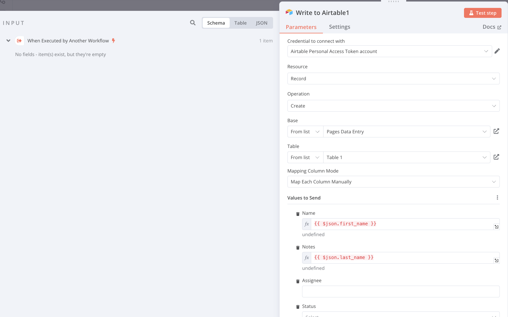

I dont get the problem. Can you provide a bit more details
Thank you everyone for your response.
Even though I understand the architecture with a sub workflow in principle. I still don’t understand why the sub workflow has no data and the nodes afterwards have red warnings.
Tried a bunch of things that ChatGPT suggested but it didn’t work either.
The data is empty:
But in the executions tab I can see it gets into the sub workflow but is not mapped properly (in the url of the screenshot you can see the executions url)
Bit exhausted by this, what else could I try?

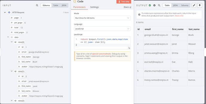

Apparently calling the subworkflow seems to be working now.
  • Code node after Http Request to process JSON
  • Execute Workflow node with settings “run for each item”
I’d like to thank you for your help!
There is still an error in my main workflow, but at least that is working now.
