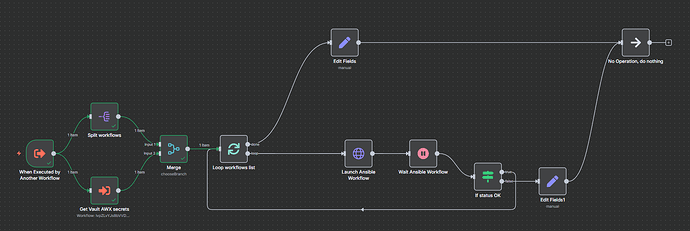

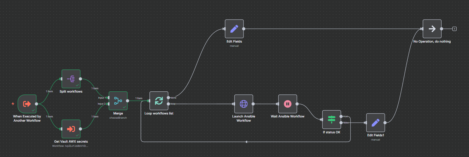

I have a very simple scenario, but I can’t get it to work. The scenario is that the main workflow calls a sub-workflow, and when the sub-workflow finishes, it returns whether it worked correctly or not.
I have run tests and the error occurs when the subworkflow has a loop. If I omit the loop, the automation works correctly, but when I add the loop, it fails.
I cannot copy the nodes because they contain a lot of personal information that I cannot share.

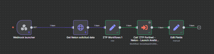

Main workflow
Sub-Workflow

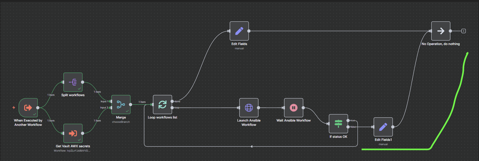

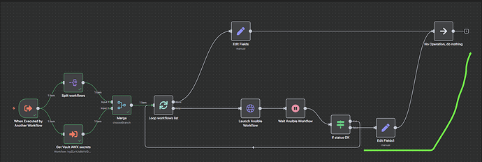

this part might be the issue
because it’s a bit weird when you are looping some items, but when it goes to false, the loop just stop n you just go “No Operations, do nothing” i am not sure what you are trying to achieve with this logic, but i think whatever the result of a loop over, the inside of a loop needs to always comes back to the loop itself, and only gets out of it through the done branch of the loop over items

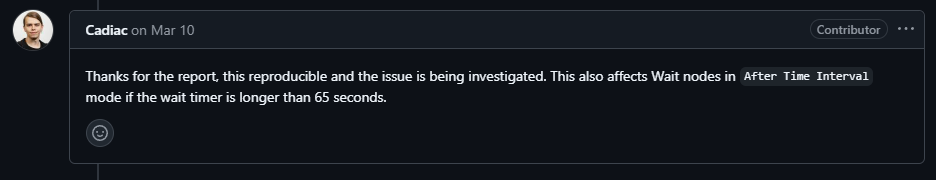

In the case you mentioned, an n8n contributor states:
Thanks for the report, this reproducible and the issue is being investigated. This also affects Wait nodes in After Time Interval mode if the wait timer is longer than 65 seconds.
This is not my case, as I do not wait for X amount of time, but rather wait for a webhook to return.

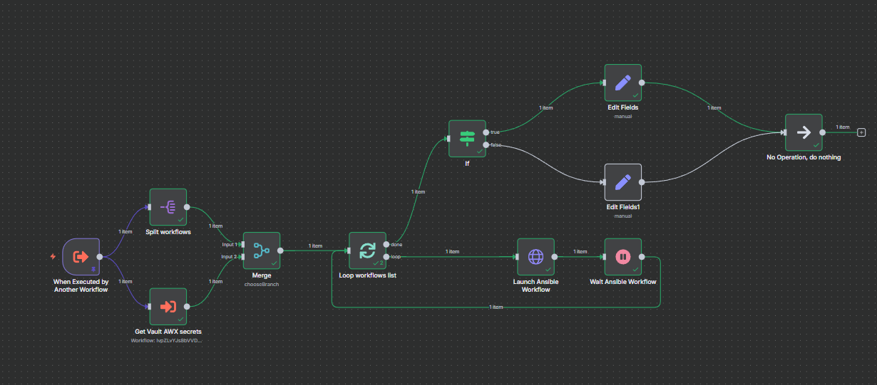

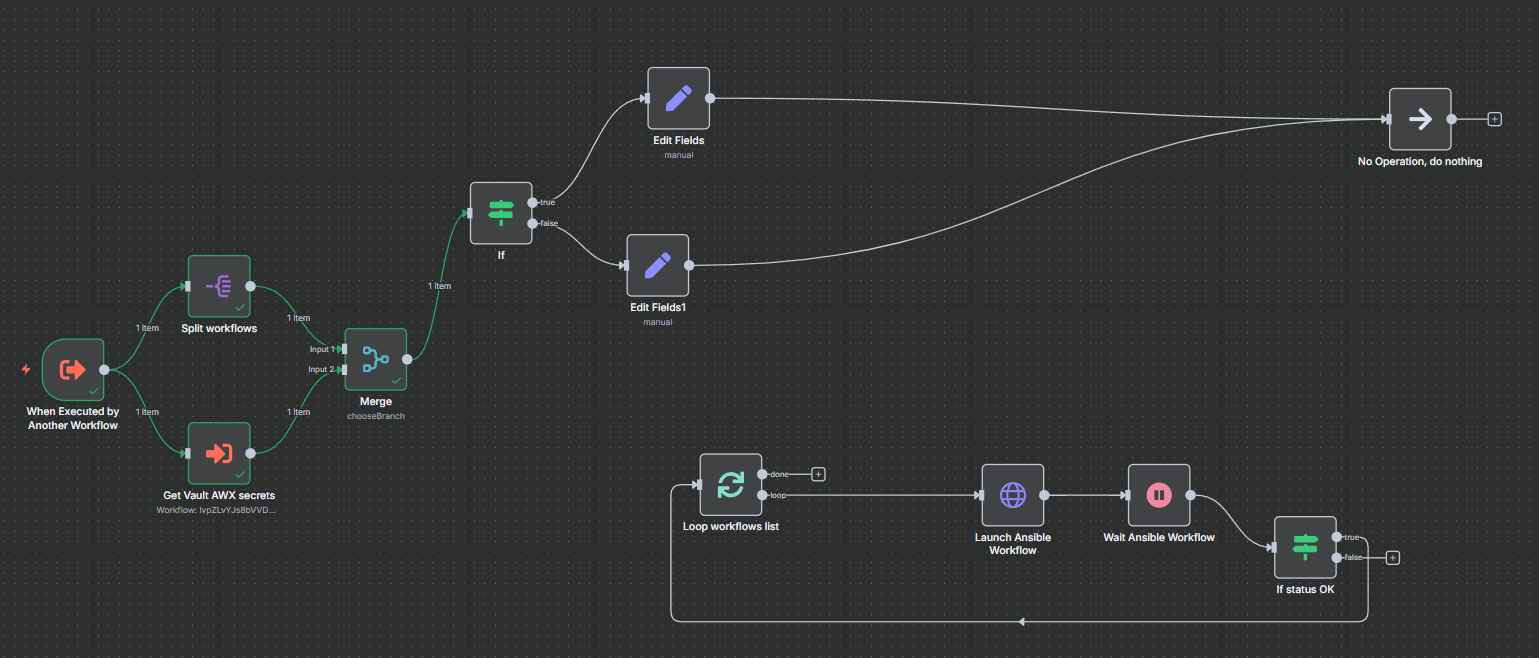

I modified my subworkflow to see if removing the if statement inside the loop would fix the error, but it didn’t :frowning:
It still doesn’t return the information requested.

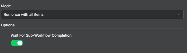

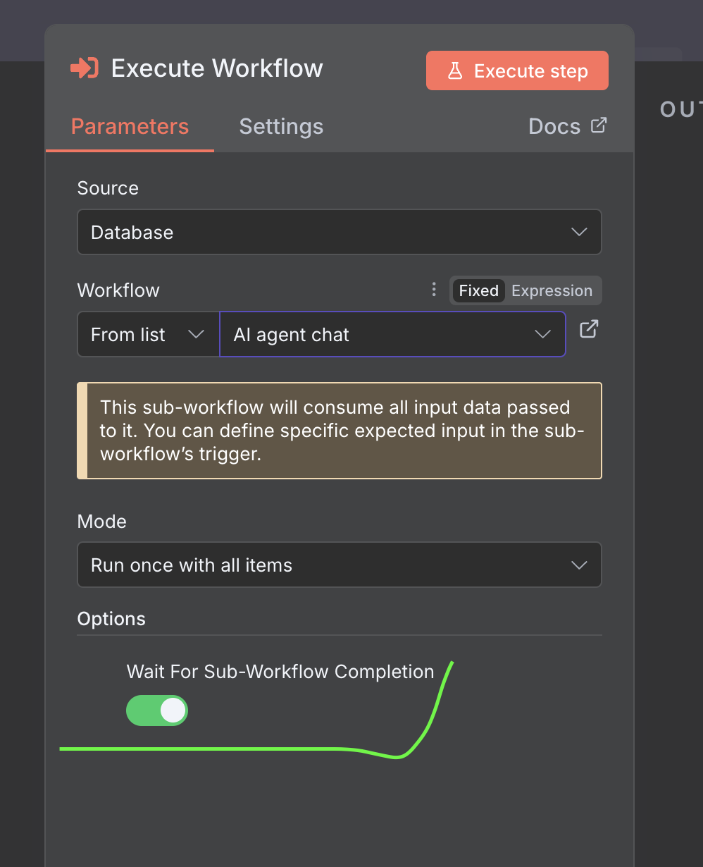

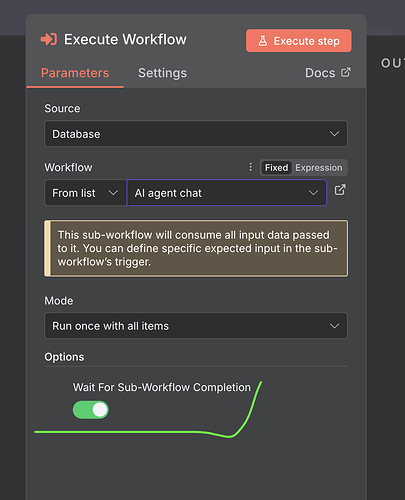

just making sure that you have enabled this upon calling the sub right?
I have tested it and confirmed it is affected by any wait node, especially when waiting for a webhook, form, response, etc. Sorry, but your flow would also be affected :confused:
You can test with a very simple 2 flow setup with whatever wait node you want to validate it for as well.
Yes, I have it marked.
