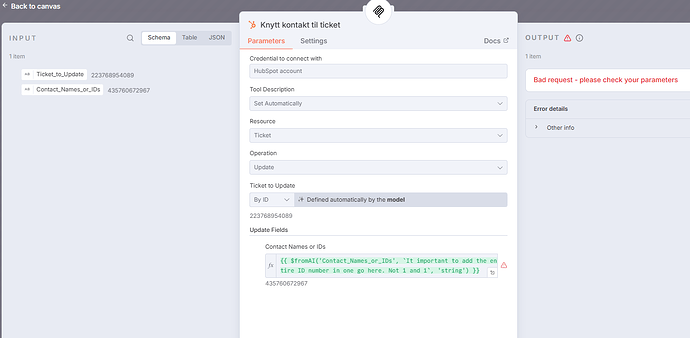

The problem i’m facing is that it fails on the last part when trying to connect the two together. The two being the contact and the ticket. For the node to do this it needs “Contact Names or IDs” and i can see in the execution log that this is being sent as a input by the chat bot, but after reading the error message on the Hubspot App, i see that the bot/node is trying to add this long number, 1 digit at a time. In my last executing the INPUT clearly shows that the Contact Names or IDs is 435744066747. And reading the logg, the bot/node tries to run this for each digit, 4 - 3 - 5 - 7… etc etc.
I believe the issue at hand is in the Request body error from the Hubspot Private app logs:
[{“fromObjectId”:223761731808,“toObjectId”:“4”,“category”:“HUBSPOT_DEFINED”,“definitionId”:16},{“fromObjectId”:223761731808,“toObjectId”:“3”,“category”:“HUBSPOT_DEFINED”,“definitionId”:16},{“fromObjectId”:223761731808,“toObjectId”:“5”,“category”:“HUBSPOT_DEFINED”,“definitionId”:16},{“fromObjectId”:223761731808,“toObjectId”:“7”,“category”:“HUBSPOT_DEFINED”,“definitionId”:16},{“fromObjectId”:223761731808,“toObjectId”:“4”,“category”:“HUBSPOT_DEFINED”,“definitionId”:16},{“fromObjectId”:223761731808,“toObjectId”:“4”,“category”:“HUBSPOT_DEFINED”,“definitionId”:16},{“fromObjectId”:223761731808,“toObjectId”:“0”,“category”:“HUBSPOT_DEFINED”,“definitionId”:16},{“fromObjectId”:223761731808,“toObjectId”:“6”,“category”:“HUBSPOT_DEFINED”,“definitionId”:16},{“fromObjectId”:223761731808,“toObjectId”:“6”,“category”:“HUBSPOT_DEFINED”,“definitionId”:16},{“fromObjectId”:223761731808,“toObjectId”:“7”,“category”:“HUBSPOT_DEFINED”,“definitionId”:16},{“fromObjectId”:223761731808,“toObjectId”:“4”,“category”:“HUBSPOT_DEFINED”,“definitionId”:16},{“fromObjectId”:223761731808,“toObjectId”:“7”,“category”:“HUBSPOT_DEFINED”,“definitionId”:16}]
I believe this should be just one line:
{“fromObjectId”:223761731808,“toObjectId”:“435744066747”,“category”:“HUBSPOT_DEFINED”,“definitionId”:16}]
But it’s not, and i don’t know how to make it so.

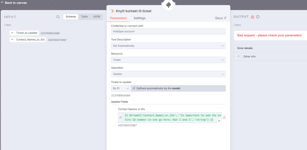

This might also be helpfull. You can see that the entire number is being passed into the field.
So it looks light this field and it’s content is being handled like it’s a array, even though its not?!
