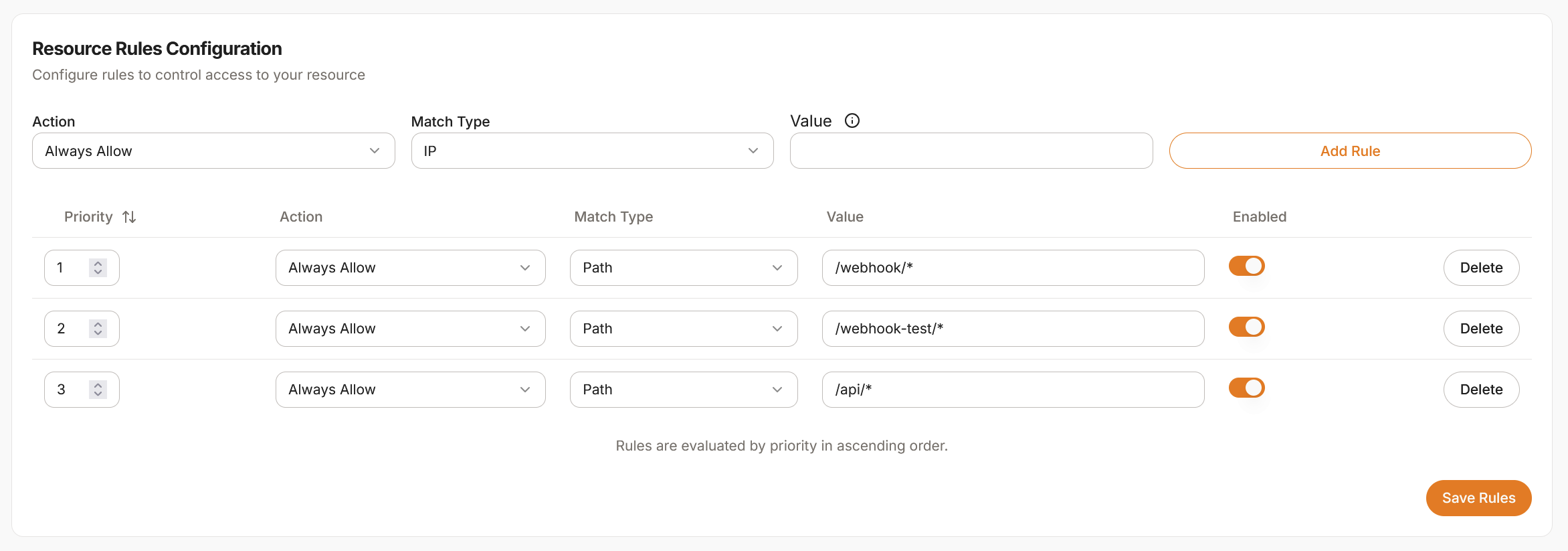

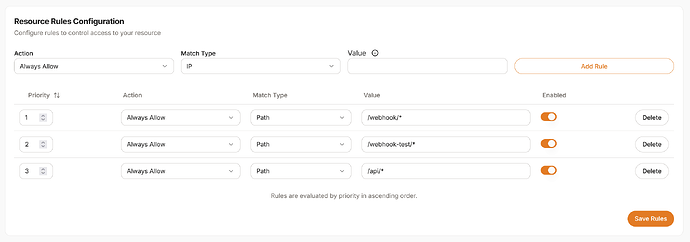

These are my rules in Pangolin

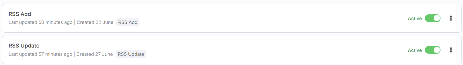

I added the variable you gave me and it didn’t work. This is my configuration enabled in n8n:

I think I have found the problem. It is due to the sum of several things:
  • When a test stream is generated with webhooks, the url “/webhook-test/*” is taken up and this is logged by N8N.
  • When the workflow is switched to active, the test url “/webhook-test/” is unregistered and the productive url “/webhook/*” is used.
This unregistration produces some problems with Grist, because it uses a queue to trigger the webhooks and it happens that if any webhook in that queue is wrong, the whole queue stops. I had 4 triggers (2 test and 2 production). It happens that N8N when activating the workflow, unregisters the test webhooks and Grist fails when trying to call the test endpoints, stopping the whole queue.
I understand why separate flows are made, however, it would be good to grant some option for the webhooks to use the same URL, whether they are test or not, via environment variable (by default there is always “/webhook-test/” and for prod is "/webhook/").
