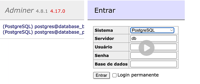

You need to have ADMINER on your VPS
{F92CACE9-F08A-402C-BEB3-63FFDA80C5A0}
Because it allows you to view the database data

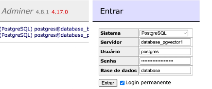

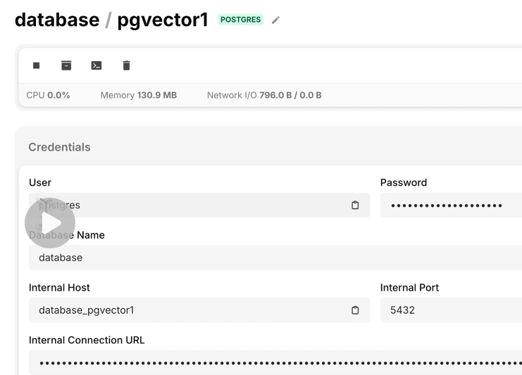

Then you need to configure the information.
Copy the data from your POSTGRES to your ADMINER
I use DIGITALOCEAN, so my interface looks like this.
Note that the errors that appear to you give you a step-by-step guide on what you need to do to resolve them.
