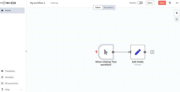

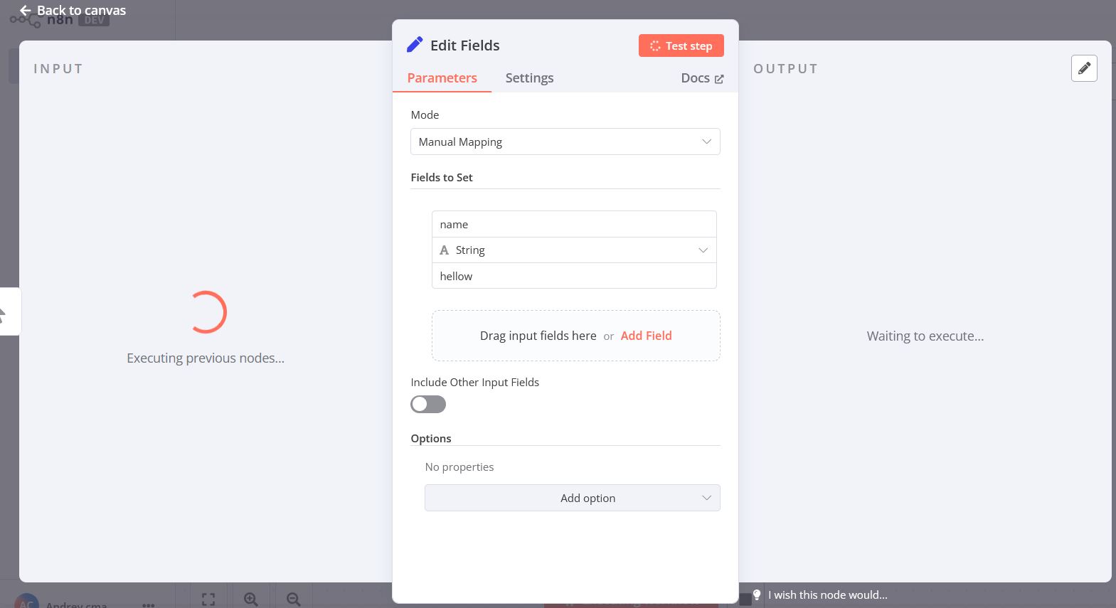

  2. When running any block, for example, Set (Edit Fields), which sets name and value, the block records but cannot complete itself.

However, the issue with the blocks hanging remains. The operation will hang under forced stop. If you forcibly click “stop operation,” the phrase “hellow” will appear in the Output block. An error is displayed in the ubuntu logs:
The session "3pvi3gfhgb" is not registered.
What could it be related to?

Enabling such settings helped solve the problems:
export N8N_PUSH_BACKEND=websocket
And adding to the Apache configuration:
# Поддержка WebSocket
RewriteEngine On
RewriteCond %{HTTP:Upgrade} =websocket [NC]
RewriteRule /(.*) ws://localhost:5678/$1 [P,L]
RewriteCond %{HTTP:Upgrade} !=websocket [NC]
RewriteRule /(.*) http://localhost:5678/$1 [P,L]
