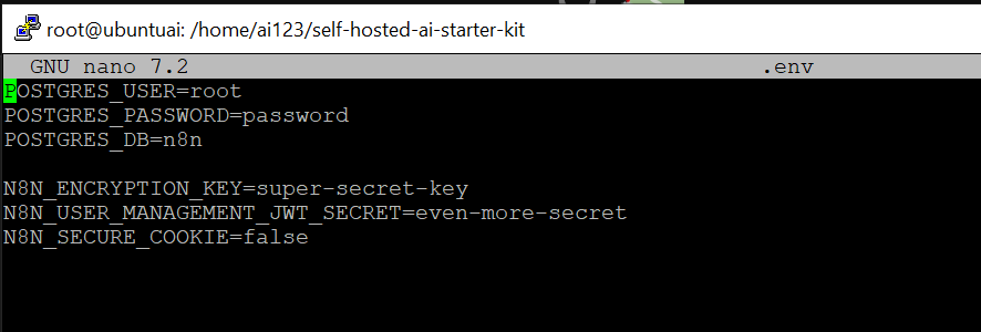

N8N_SECURE_COOKIE to false
So i tried to install the docker n8n AI starter-kit on my proxmox VM and i get an page that prompts me to disable secure cookies or use localhost. i cannot seem to find an option to disable cookies anywhere and localhost isnt an option since its an ubuntu server VM.

The cookie accesibility is controlled by the environmental variable N8N_SECURE_COOKIE. It is mentioned in Security environment variables | n8n Docs.
If you are using our AI Starter Kit, the environmental variables reside in self-hosted-ai-starter-kit/.env at main · n8n-io/self-hosted-ai-starter-kit · GitHub.

as im using the ai-starter-kit now i managed to find its .env file but even after adding “SECURE_COOKIE” line the error persists.
