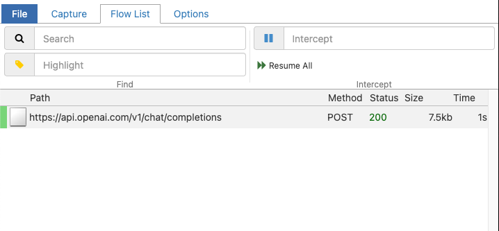

Hey, @nicolas.matelot hope all is well.
I have my n8n behind personal proxy for inspecting http requests and I do see requests from ai agent hitting the proxy.
The way my n8n is configured for that is:
  • I have mitmproxy running in a separate container
  • mitmproxy generates a certificate, which needs to be added to the trust source of the n8n container
  • this certificate is mounted into n8n:
    • - ./mitmproxy:/opt/custom-certificates
  • when n8n detects there a new certificate, it imports it from docker-entrypoint.sh, which looks like this (it’s already there, no need to change anything):
#!/bin/sh
if [ -d /opt/custom-certificates ]; then
  echo "Trusting custom certificates from /opt/custom-certificates."
  export NODE_OPTIONS="--use-openssl-ca $NODE_OPTIONS"
  export SSL_CERT_DIR=/opt/custom-certificates
  c_rehash /opt/custom-certificates
fi
if [ "$#" -gt 0 ]; then
  # Got started with arguments
  exec n8n "$@"
else
  # Got started without arguments
  exec n8n
fi
  • I have these ENV VARs configured for n8n
    • - HTTP_PROXY=http://mitmproxy:8080
    • - HTTPS_PROXY=http://mitmproxy:8080
At this point when I use AI Agent with OpenAI model, I see the following in mitmproxy:
Hope this helps you.
