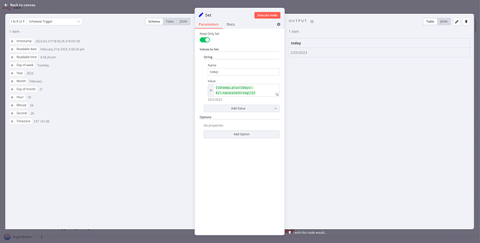

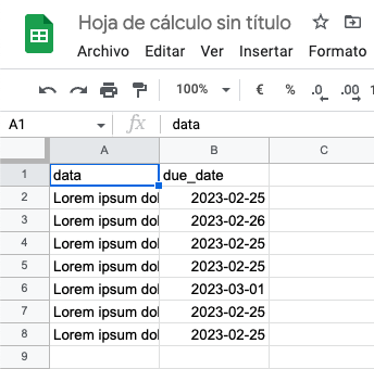

Hi @chandan988 ,
From what you describe, the workflow must run some kind of reminder. If so, a simple approach is the following workflow:
Source:
  • Run the workflow automatically once a day with the Schedule Trigger node.
  • Then define the variable “date” in the Set node, adding the 4 days margin until the due date.
  • Format the date field to match the format of the due_date field in the Google Sheets sheet (this step is optional, it will depend on how the fields are formatted).
  • We list the spreadsheet data, filtering the rows that only match their “due_date” column by the date we have set in the Set node and formatted in the previous node.
From here, you can continue the workflow with the steps you want.
:wink:

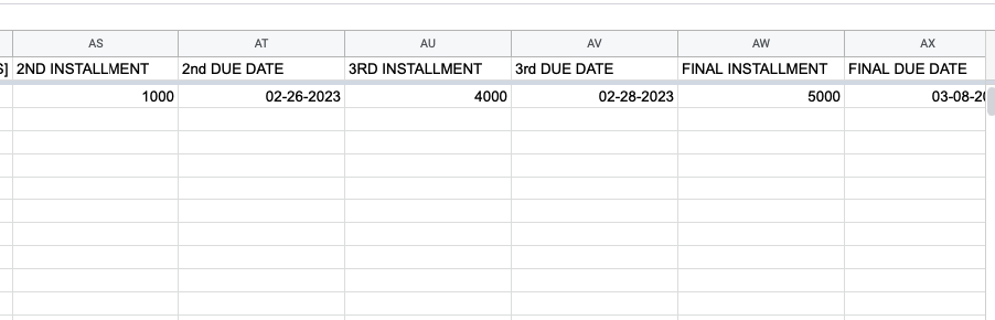

Let me clear
Due date is suppose 25 Feb 2023, Then reminder should go 3 days before due date
this is my google sheet, Due Date is 26 Feb 2023, But i want to run this 3 days before ie on 23 Feb only to send email & sms
