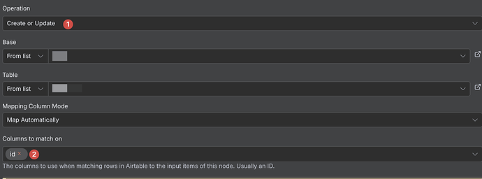

Thanks for your advise. I notice each time after I run the workflow, Airtable is added new 14 records to the table rather than renew the data from table. It will cause many repeat datas based on how many times I run the workflow.
Do you have any idea how to solve this problem?
Yes, you are right. But how to renew the data rather than add new same data into the same table after running the workflow repeatedly.
You can use create or update
And use order_id as match on. So it will only create new order when the order_id is new.
Thanks @darrell_tw. It’s really helpful!
