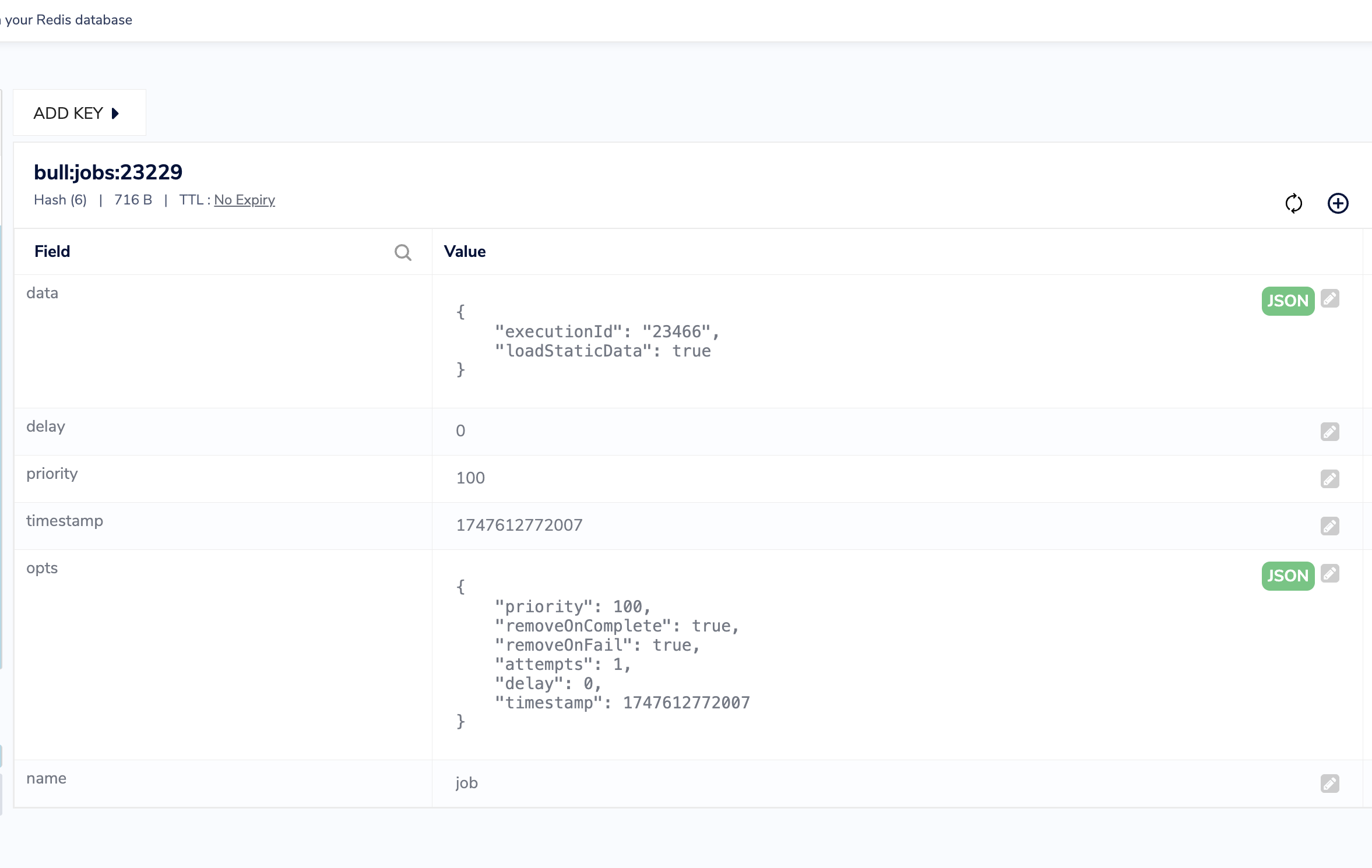

Hi,
My issue is the same as here . We have setup a queue mode with redis but as soon as we turn on EXECUTION_MODE=queue, our webhook keep saying “Starting Soon”. When we pass it again on “regular”, everything goes well.
We see in the main logs that job is added to the queue but nothing happen on the worker level.
I have posted yesterday about an issue with our startup licence , this is not clear for me if these two are related. Or should i say if the redis service can not work without a Startup/Entreprise licence (this is not clear for me yet).
Here is bellow our config

FYI the solution provided has not worked. We finaly got a new startup key and the issue still sticks. I see that many people have posted about this but no one provided a clear solution
How are you deploying your worker node? Can you share ure dockerfile, it needs to run ‘n8n worker’ command.

Hey @mpst
Applogies for the deplayed reply, but did you try checking
Is your n8n-worker container starting correctly?
docker service logs n8n-worker
Inside the container, check if Redis is reachable:
docker exec -it <worker_container> ping redis
It seems like a network issue, as the worker only need to access redis and the db. redis just posts some details for the wokers pickup, it very minimal see image
After the worker receives this, it calls the db for everything it needs.
Best regards,
Samuel
