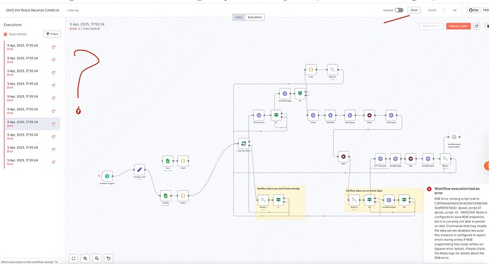

Hi n8n team,
We are running n8n in queue mode with scaling and Redis, and recently started encountering a large number of executions stuck in the “Error” + “Starting soon” state.
Here are our setup details and what we’ve done so far:
:white_check_mark: Setup Info:
  • **n8n version:**1.85.4
  • PostgreSQL version: 16
  • Redis: 7
  • Deployment: Docker Compose
  • Executions Mode: queue
  • Workers Enabled: N8N_RUNNERS_ENABLED=true
  • Offload manual execs: OFFLOAD_MANUAL_EXECUTIONS_TO_WORKERS=true
:package: .env / docker-compose (relevant section):
yaml
CopyEdit
environment:
  • EXECUTIONS_MODE=queue
  • N8N_RUNNERS_ENABLED=true
  • OFFLOAD_MANUAL_EXECUTIONS_TO_WORKERS=true
  • QUEUE_BULL_REDIS_HOST=redis
  • QUEUE_BULL_REDIS_PORT=6379
  • GENERIC_TIMEZONE=Europe/Bucharest
:broom: Actions already taken:
  • Flushed Redis completely via FLUSHALL
  • Cleared executions from PostgreSQL with:
    sql
    CopyEdit
DELETE FROM public.execution_entity WHERE status IS NULL OR status NOT IN (‘success’, ‘error’, ‘manual’);
  • Restarted all containers
  • Checked logs for errors, nothing critical apart from:
    javascript
    CopyEdit
Error – Starting soon
  • Timestamp – 29064405:15m
:cross_mark: Current behavior:
  • Workflows fail to run properly and get stuck in “Starting soon” + “Error”
  • Invalid-looking timestamps in execution logs (e.g. 29064405:15m)
  • Recreating workflows does not solve the issue
:folded_hands: What we need:
As you can see some workflows do not even have scheduled enabled but still get this error, they are not even active

Hey all,
I was able to troubleshoot and fix this issue.
It’s definitely a weird side case, but I have a feeling it’s everyone’s issue.
Make sure you don’t allow redis to be access by the public!
