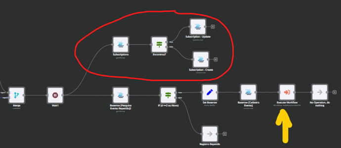

And in this other one, the image of the total flow of the “first part”:
See that this flow is started by the Rabbit node, but it calls another flow through the “Execute Workflow” node. (which by the way calls another “Execute Workflow”)
And, as I update a database on the same record, I need one flow to finish to run the next one.
Am I doing something wrong?

hello @Evandro_Caruso
For how long is it set to wait in the Wait node?
And I don’t like that part of the workflow, as it may cause some issues ( you have 2 exit points in the workflow)
Hummm…
Good point about these 2 exits… I will integrate them using Merge node.
Forget about Wait node… I just put it to try to understand… I already take it off…
I will come back with notice…
@barn4k
Great News!!! You were right!
The n8n was indicating as “flow finished” when “one path” had finished… Not when the entire flow had finished.
I placed a Merge node waiting for the 2 inputs and it is working perfectly!
Thank you very much for your insight and your time.
