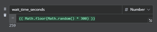

Set/Edit Fields:
Fields to Set: wait_time_seconds = {{ Math.floor(Math.random() * 300) }}

I notice those nodes where empty and added this to my original post to show the javascript I’m using to generate the random number.
I don’t know why those nodes were cleared when I downloaded the workflow.
I’ll try it again here.
Ah interesting. That should work. I’d say, unless need elsewhere, make that an inline expression on the wait node rather than pre-set. Or try not force cast it within the set node as a string, that could be the issue. It should be a number.
Just had to change the type of the “Fields to Set” from String to Number and it now works correctly.
