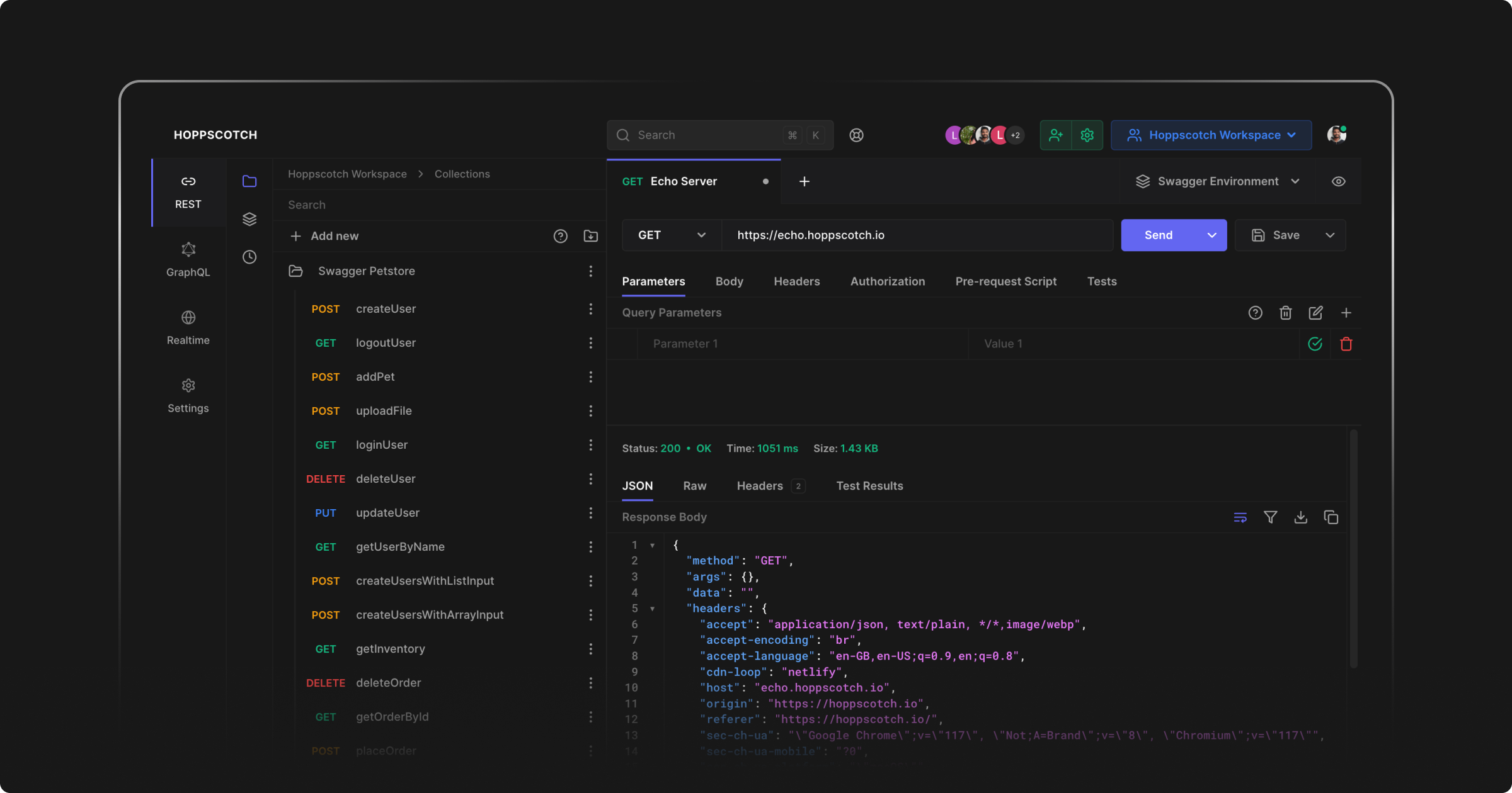

@hasamba Yeah like first get the idea about the problem that is it the API of notion or n8n, cause it sounds like it is n8n but as you have suggested it is not, so consider using it with some service like postman or just use what i use daily:
