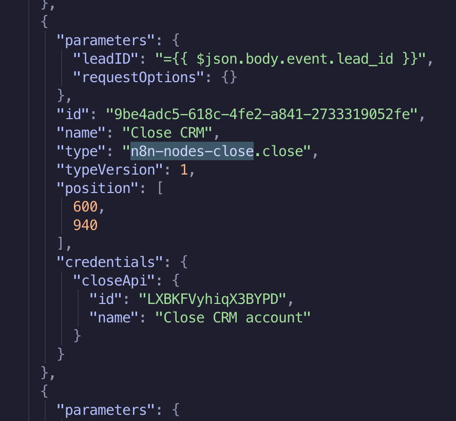

When I restart my docker container (dyno on Heroku), it always says there is an error with a community node I’ve installed. The db doesn’t change before/after restart as far as I can tell.
It can be fixed by re-installing the community node, but I don’t want to require a manual step every time the application restarts

Hi @Ian_Gillis, could you maybe share your docker setup? And what version of n8n are you suing?
I just used the Heroku setup that n8n published: GitHub - n8n-io/n8n-heroku
It looks like that’s pulling latest from DockerHub – is it possible that’s the issue? Something like:
  • Heroku does a nightly restart (or similar)
  • There’s almost always a new version of latest
  • For some reason, upgrading resets your installed community nodes
Mostly just conjecture, I don’t know how community node installation actually works.
Read through the code and I still don’t fully understand why the package/node is considered missing. It looks like the db is consistent.
But I did find this config N8N_REINSTALL_MISSING_PACKAGES so going to try setting it and see if that helps.
